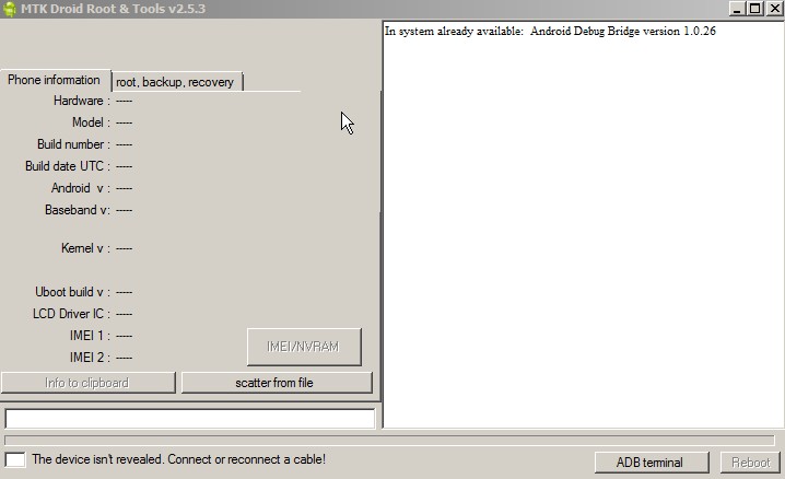

There's a good change you run into error: file adbd not install while doing an MTK Droid tools backup, When faced with such, this guide will explain what to do
Steps to fix error: file adbd not install in MTK Droid tools
Follow the steps below to resolve the adbd not install error
  1. Exit PdaNet in system tray if open
  2. Close MTK droid tools
  3. Disconnect the phone from PC
  4. Download Busybox apk @ https://play.google.com/store/apps/detai...on.busybox
  5. Install Busybox on the phone and click Open after installation
  6. Wait for initialization to finish (100%)
  7. Still in Busybox, click Install wand wait till you get a prompt saying installation was successful
  8. Re-launch MTK droid tools
  9. Reconnect the phone to PC
If the issue persists after the above steps then [Image: file-adbd-not-install.jpg]
  • MTK Droid tools only works on old MTK chips so this guide won't work for new MTK chipets and Android version
  • If you're trying to backup then consider using Wwr_MTK tool

please i need an explanation why my phone is not reading on MTK droid. i have done all procedure, still encounter error.
please see attached.
Thanks.
51,016
13-03-2016, 02:46 PM
(12-03-2016, 09:19 AM)dj_accex please i need an explanation why my phone is not reading on MTK droid. i have done all procedure, still encounter error.
Thanks.
you need to install appropriate drivers.
see https://www.hovatek.com/forum/thread-468.html
