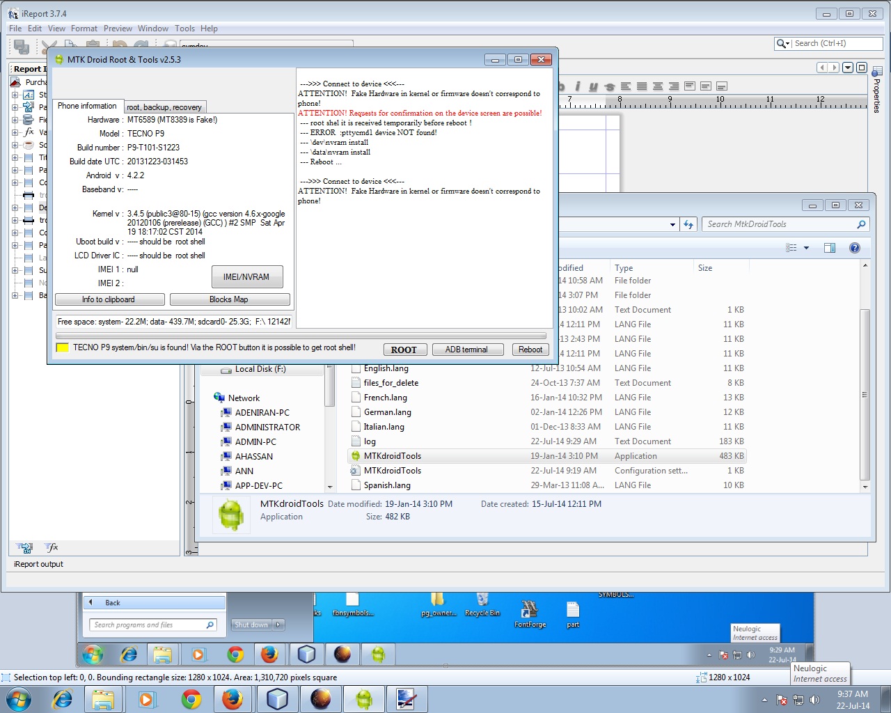

Pls, find attached screenshot of my result after restore. If u notice in the left pane u will see that the baseband is empty and on the right side pttycmd1 is not found. The pttycmd1 is looking is from the radio folder which is not there.
I eventually got a same model phone yesterday and the all things possible that is why i said show me step by step. What i eventually found out is that the radio folder doesnt retain its files because i copied all the files from the same folder and pasted it in faulty p9 but after restart the folder is empty again. Pls help.

Do you still have access to a working P9? and is it rooted?
