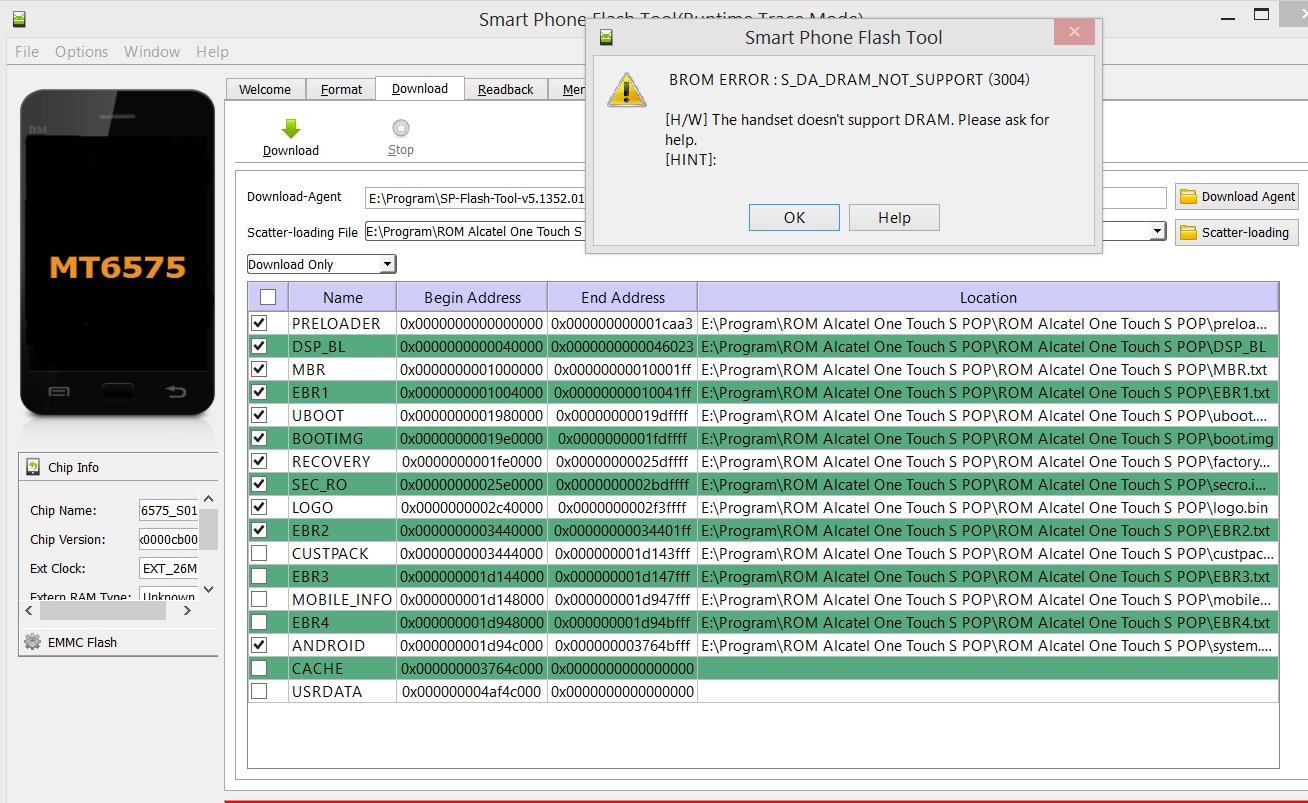

Hello i have a problem issue with sp flash tool... my phone alcatel ot spop 4030x is bricked and im trying to flash custom rom, but im end up with: brom error s_da_dram_not_support (3004) and i dont know what this mean and how to fix it. if there is a way to hellp me, please do...

(29-12-2014, 05:53 PM)Grncharov Hello i have a problem issue with sp flash tool... my phone alcatel ot spop 4030x is bricked and im trying to flash custom rom, but im end up with: brom error s_da_dram_not_support (3004) and i dont know what this mean and how to fix it. if there is a way to hellp me, please do...
1. how did your phone get bricked?
2. what does it show when you try booting ?
3. are you trying to flash stock or custom ROM?
4. list all files contained in the ROM you're trying to flash?
5. at the bottom of the error is a hint, what does it say?

I was trying to flash custom rom (MIUI V.5) but in SPFT by mistake i hit format Sad
i downloaded stock 4030x rom and when i try to flash:
brom error not enough storage space (1011) [HINT]: {[none]} ---> with SPFT V.4.0
brom error s_da_dram_not_support (3004) [HINT]: Please make sure there is a correct load in the target.---> with SP_Flash_Tool_v5.1352.01 ; v3.1344.0.212
brom error s_dl_get_dram_setting_fail (5054) [HINT]: Please check your load matches to your target which is to be downloaded.---> with SP_Flash_Tool_v3.1222.00
custom rom downloaded from http://www.movilesdualsim.com/tema/rom-a...olf.60016/
----> https://www.dropbox.com/s/ijeoz4c3aidesn...%20POP.zip
state of phone - doesnt power on, black screen
cant flash custom or stock rom/recovery

(30-12-2014, 01:32 AM)Grncharov I was trying to flash custom rom (MIUI V.5) but in SPFT by mistake i hit format Sad
from all the above errors, the stock ROM isn't compatible with your phone. try deleting the sp flash tool folder and re-retracting then flashing again.

so, i need to delete all folders of all versions of SP flash tool, than extract and try again
or i`ll need another rom ?
because if i need to try with another rom, i cant do that .,...
i dont know from where to download.

(30-12-2014, 09:49 AM)Grncharov so, i need to delete all folders of all versions of SP flash tool, than extract and try again
delete all folders of all versions of SP flash tool, then extract and try again

i reinstaled windows
now i have win7 x64
i instaled all adb and preloader drivers but i get same error when i try to flash

(31-12-2014, 08:05 PM)Grncharov i reinstaled windows
now i have win7 x64
means you'll need to get the correct backup for your exact phone model because the one you have isn't

but i dont have the backup, and the rom im trying to flash is the only one i have and i downloaded from net.
q: if i perform backup on another spop 4030x, will it work on my phone ?

(01-01-2015, 06:29 PM)Grncharov but i dont have the backup, and the rom im trying to flash is the only one i have and i downloaded from net.
Happy New Year
It should work. forgot to ask, is the phone an MTK phone?
