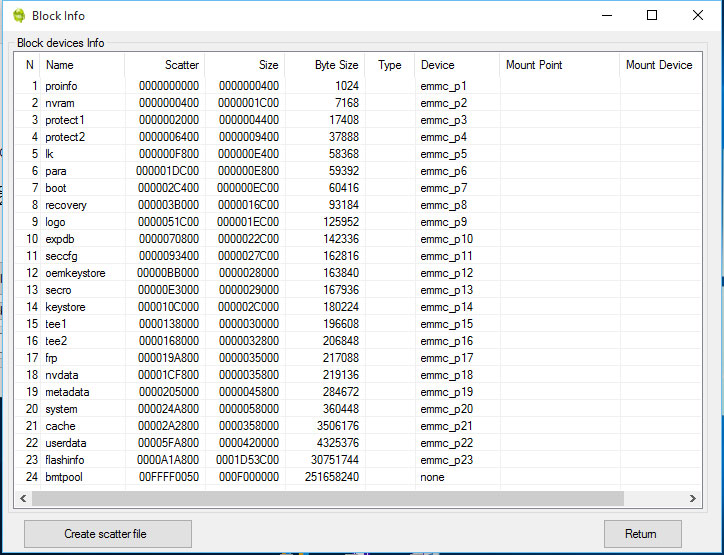

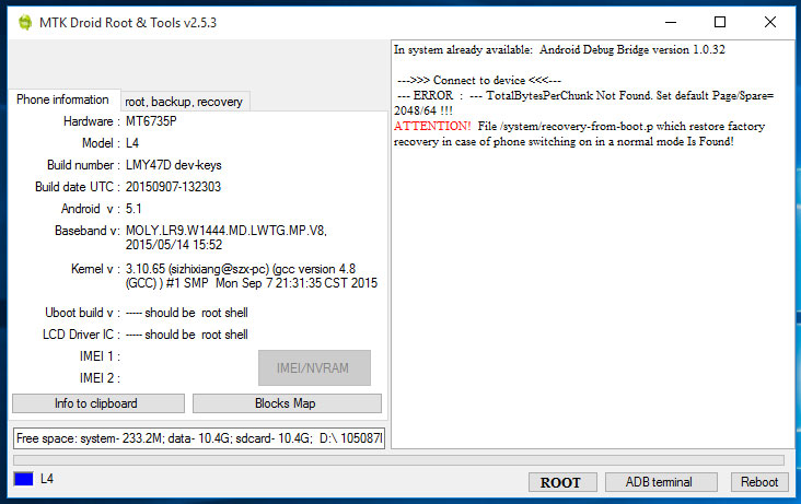

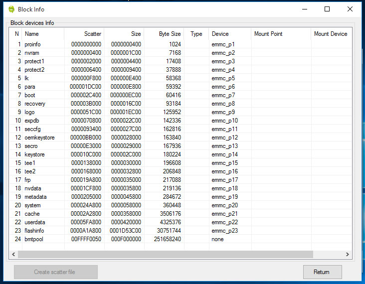

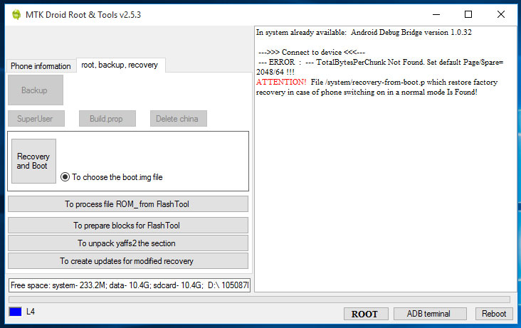

My purpose is to create scatter file for iNew L4 (MT6735p chipset) but MTK Droid Tools provides a grayed out button "Create Scatter File" with an error on the main connection log."TotalBytesPerChunk Not Found. Set default Page/Spare=2048/64" (screnshots attached)
After searching a lot I tried a recommendation to use SD card and install Busybox but it was of no use as the problem persisted. I have at least 10GB free space on Phone storage + 7 GB free space on SD card. Default write set to SD card. Installed Busybox (no-root) app from Play store (https://play.google.com/store/apps/detai...ps.busybox) because the phone is not rooted (it's not even able to root as far as I have tried various methods including root option in MTK Droid Tools).
Note: I have tried with another Infinix phone with MT6592 chipset, everything goes fine from connection to creating scatter files and backup/recovery etc. But I am only having problem with iNew L4 smartphone which has MT6735P chipset.
Can anyone please suggest something about it?

The presently latest version of MTK Droid tools doesn't fully support this chipset

That's kind a relaxing reply. So there is no solution available to this right now; that's what you mean? Or is there anything I could try?

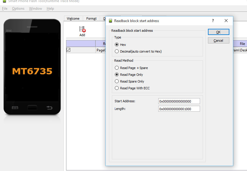

- Found the MT6735M scatter file on the web from various places, so thought try this one with the phone but SP Flash Tool can not even start Readback process as it couldn't match the scatter file with the connected phone.

(10-11-2015, 07:39 AM)pjmanzo try editting the mtkdroid tools configuration file. Change the list of supported chipsets. Its located in the same folder as the mtkdroid tools folder.

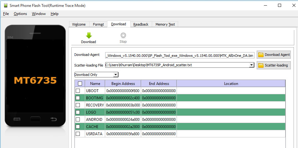

after adding the chipset model MT6735P in the ini file, the tool indeed let me create the scatter file.
But the file's format is not similar to what I have seen and worked with other phones.

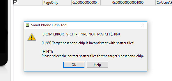

Anyways, I tried with that scatter file but the SP Flash Tool couldn't readback while prompted me with the following error.
"Target baseband chip is inconsistent with scatter files!"
I have attached the scatter file as well as the screen shots of the process.
Note: When connected to MTK Droid Tools, the tool also states with an error as mentioned in original post above. It's still intact even after adding the chip model in ini.

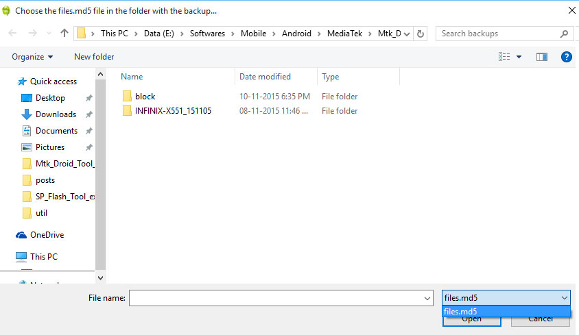

10-11-2015, 01:37 PM
then bro open mtkdroid tools again and go to the backup, restore tab. Then click the option named "to prepare blocks for flash tool" and wait. Files shall be generated to become flashable. You can see it at the backups folder. Some files may be missing but I managed to find them since I already backed up my rom using droidtools.
pjmanzo
pjmanzo
pjmanzo
19
10-11-2015, 01:40 PM
also, dont use the scatter file from the backups folder. Use the scatter from "!files to flashtool" folder. Scatter file should be at the same folder with the files to be flashed. Another one, edit name the scatter.txt to have your chipset model(MT6572 in my case).
