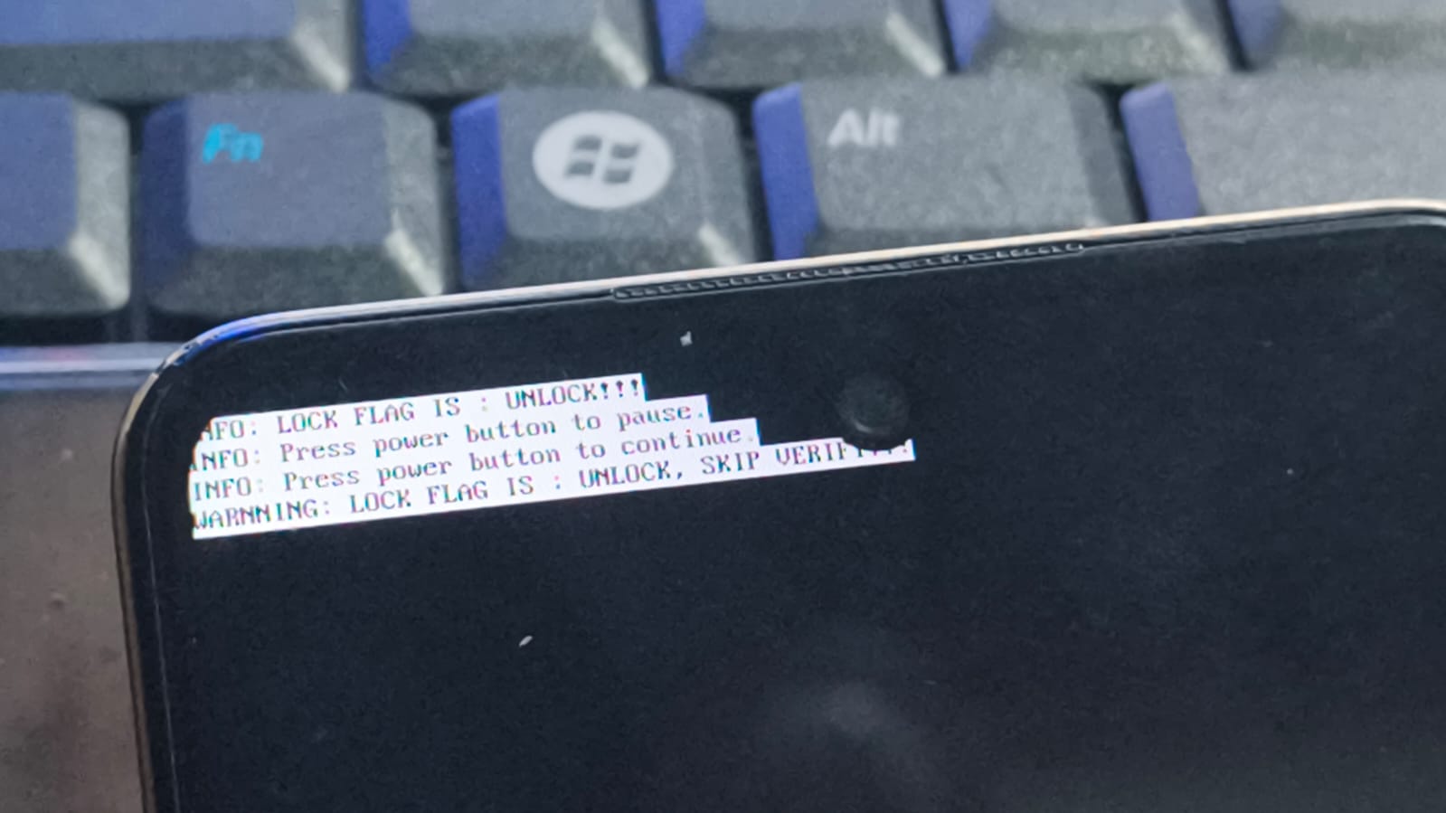

The phone booted, but with errors, and was stuck. First it showed this:

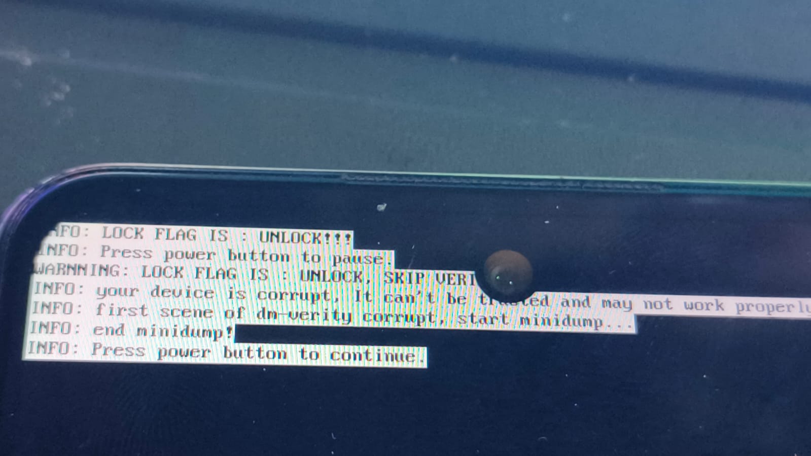

Then it rebooted and got stuck at this screen:
The bootloader was unlocked, but some partitions were messed up with dm-verity corruption.
This was where I encountered the third issue with UnlockTool; Flashing the super partition kept timing out at 6%, so it was unflashable.
I chose Hydra Tool for its partition manager feature and to retry flashing the PAC file with the super partition as my primary objective. Although it looped several times on the super partition, it wrote “OK”. Was it successfully flashed? I didn’t know. The phone was still stuck at that screen, but the super partition was probably back to stock…or not. The only way to tell was to do a readback then unpack and check… too much work at the time.
At this point, I looked at the partitions.xml I had obtained from spd_dump. It was an A/B device, so the only two reasons I could think of (why it was still this way despite flashing the PAC file with UnlockTool and Hydra Tool) were that either the PAC file was incompatible (unlikely) or the inactive slots had been tampered with (possible). Come to think of it, the deadboot repair file that had been flashed would’ve written to these partitions. That could explain the dm-verity error.
