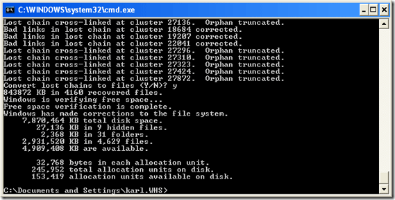

1. Chkdsk: The Chkdsk command can be used to scan and fix errors on a storage device. To use it
- Go to My Computer
- Take note of the storage device’s drive letter (e.g G, H, I etc)
- Use Windows start menu to search for cmd.exe
- Run cmd.exe as Administrator
- Type cd\ then press Enter
- Assuming the drive letter is G, type chkdsk /f G: then press Enter (ensure to space each item)
- Wait for the operation to finish running
