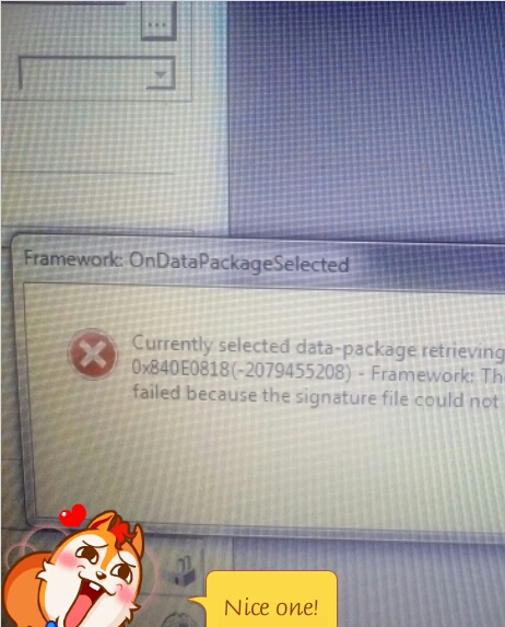

The problem is that, when I got to the stage of reburbish after clicking on dead phone USB flashing.. It always displayed
 "no data-pakage selected (product code is empty). Select the product code and try again"
So, I proceeded to selecting code, chooses the code and it displayed this again
"Currently selected data-package retrieving failed"

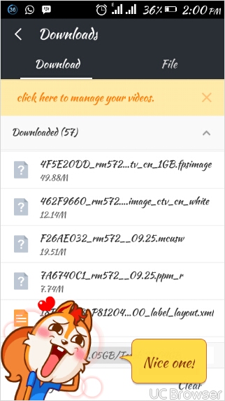

sir_bidex
sir_bidex
sir_bidex
57
12-10-2015, 02:12 PM

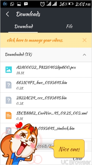

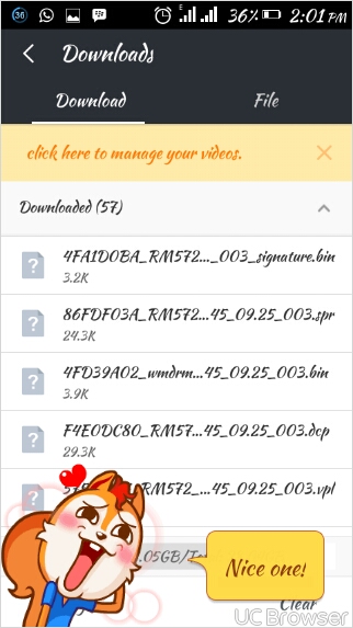

Yes boss.. Here are the list

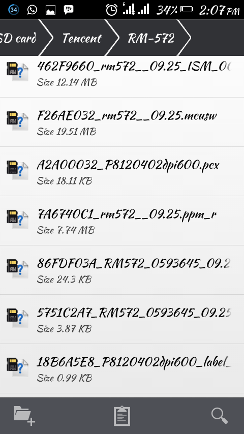

sir_bidex
sir_bidex
sir_bidex
57
12-10-2015, 02:18 PM

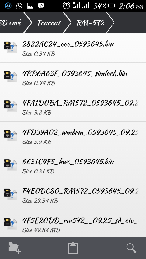

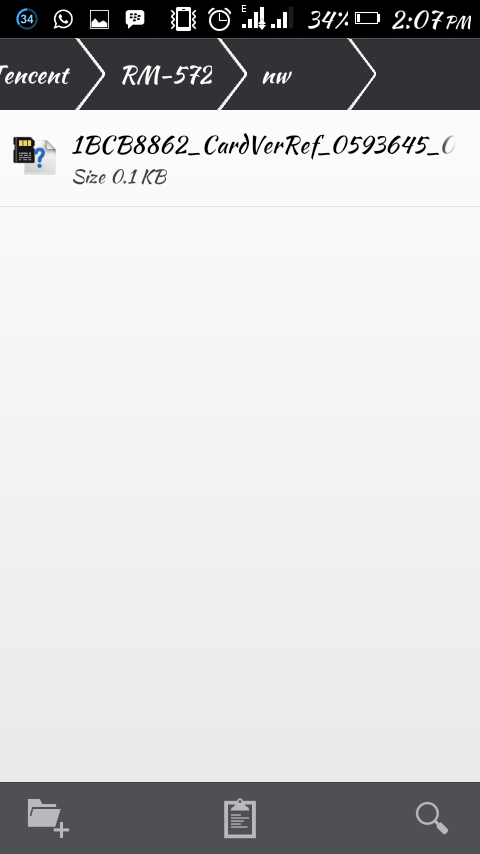

Yes, I did as instructed... Here is another screenshot
X3non
X3non
X3non
Recognized Contributor
22,062
13-10-2015, 09:47 PM
(12-10-2015, 02:18 PM)sir_bidex Yes, I did as instructed... Here is another screenshot
you would need to rename the files you downloaded.. the server adds junk at the beginning of the file name..
lemme use the 2nd screenshot you posted as example
REMOVE everything from the beginning till the first underscore sign "_"
2822AC24_ccc_0593645.bin  TO   ccc_0593645.bin
4BB6A63F_0593645_simlock.bin  TO  0593645_simlock.bin
4FA1DOBA_RM572_0593645_09...  TO  RM572_0593645_09...
do this for every single file and the error should be corrected

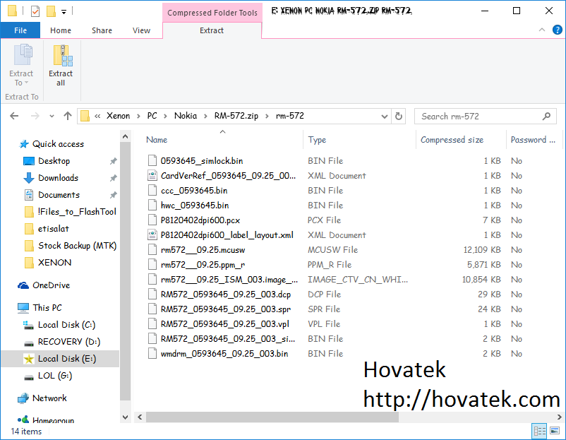

see the pic below for reference
