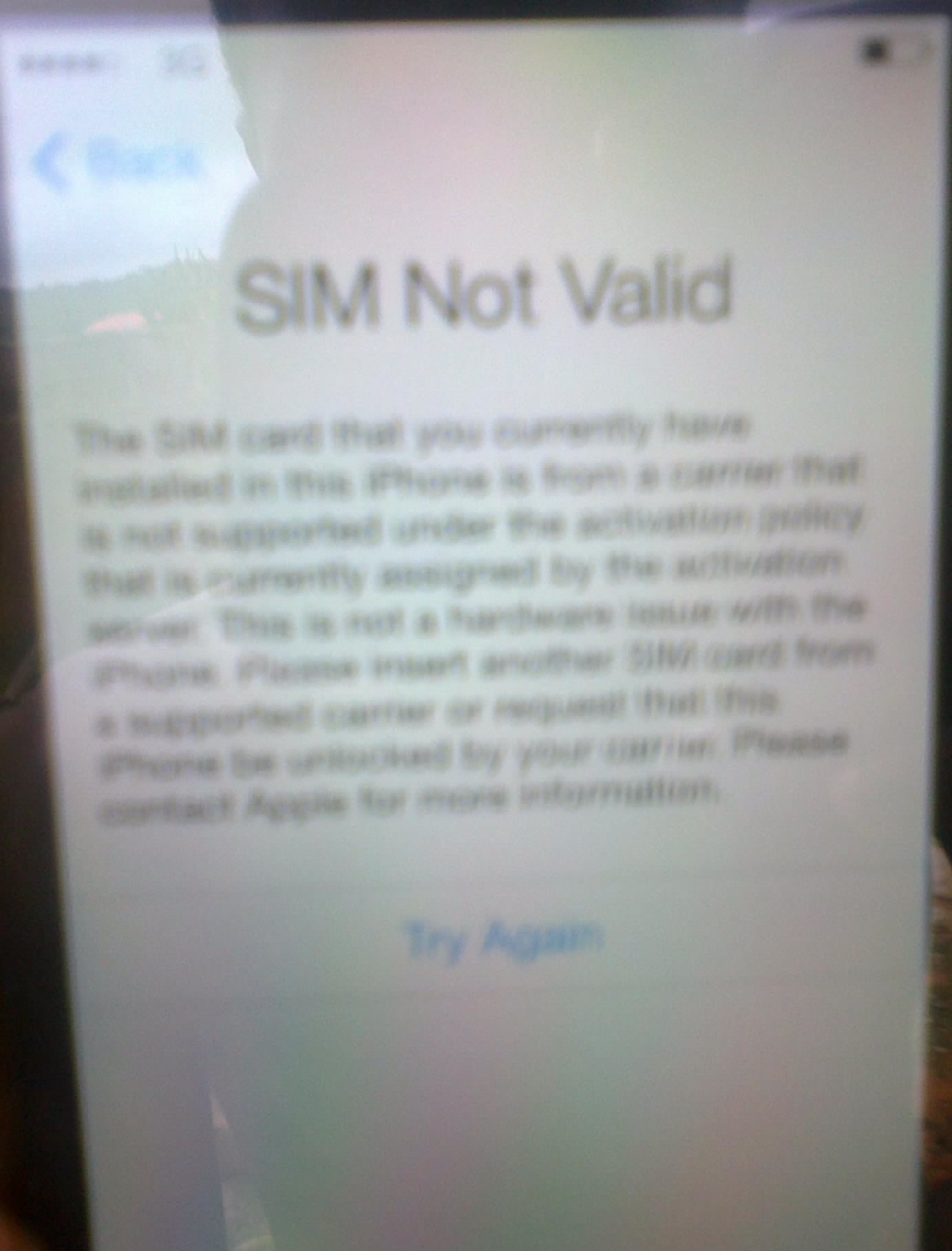

i bought this iphone 4s from a guy only to find out thats it locked to Vodafone Egypt... It does not accept nigeria sim card... On activation screen, it displays SIM NOT VALID, BUT DISPLAYS NETWORK 3G... So i cant pass the activation server to check if it on icloud lock or not.... PLS I CAN I UNLOCK IT TO USE NIGERIA SIM CARD????

(19-07-2015, 01:21 PM)mp4barca i dnt knw cos i cant bypass activation screen cos it always showing invalid sim card on all nigeria sim
is it network or icloud activatin screen you see? why not post a picture of it so I get you

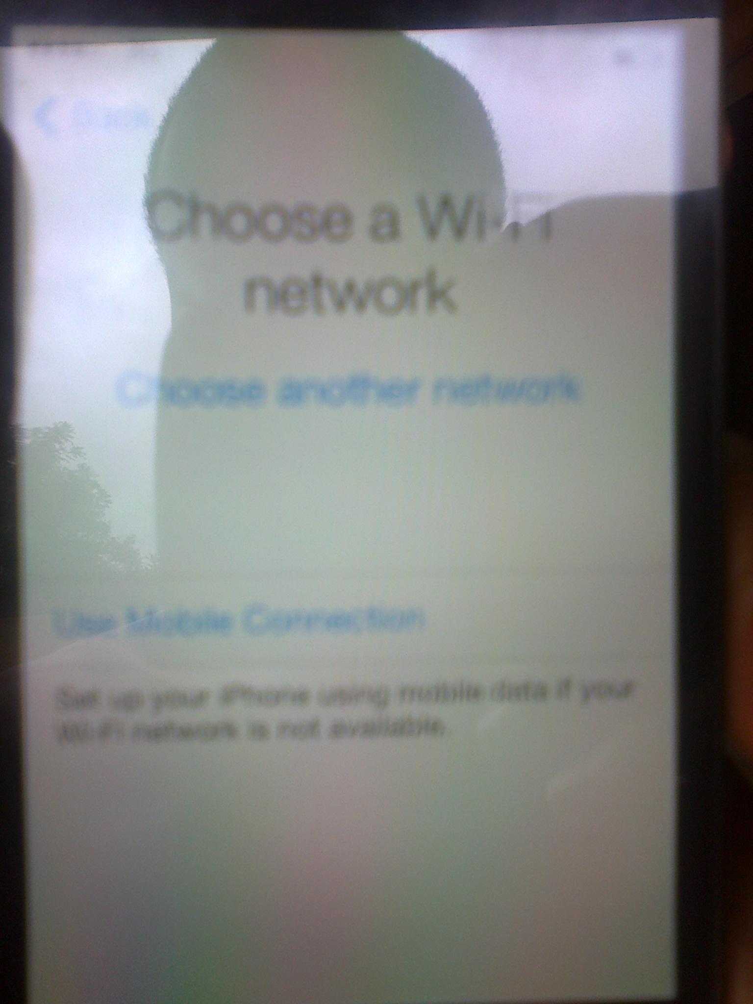

20-07-2015, 09:19 AM
Pictures

20-07-2015, 02:48 PM
(20-07-2015, 09:19 AM)mp4barca Pictures
create a Wi-Fi hotspot using another phone then connect the iPhone to the Hotspot so you can proceed with Jailbreaking
