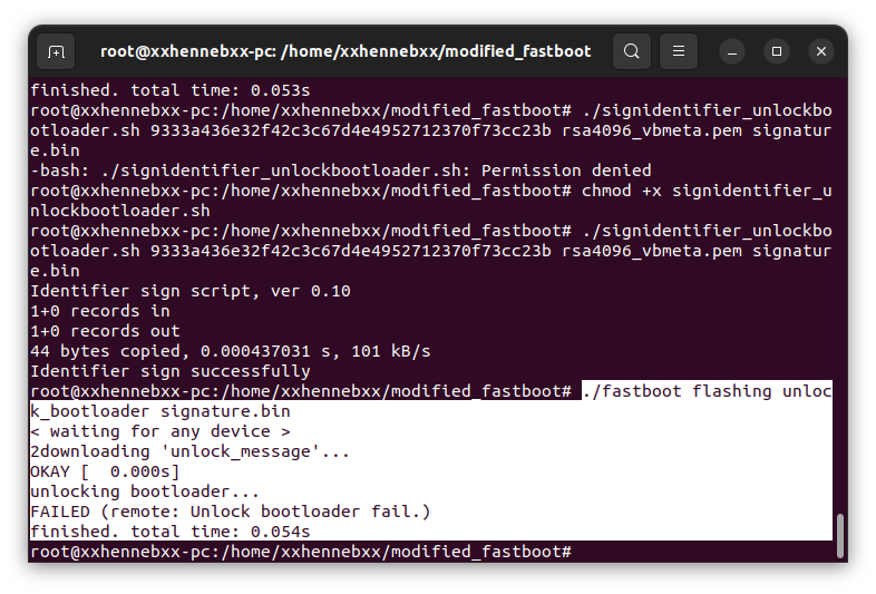

hello ive been following your guides. and man gotta first say. VERY IMPRESSED with your work !! and anyone else working alongside !! plan to take some courses soon as im a  dev myself !! love working on android systems !!
anywho, got all the way to the end until i reach this error.  i just need some guidance on how to take the received output and resign with the correct code
./fastboot flashing unlock_bootloader signature.bin
downloading 'unlock_message'...
OKAY [  0.000s]
unlocking bootloader...
FAILED (remote: Unlock bootloader fail.)
finished. total time: 0.054s
this is my vbmeta-sign.img output

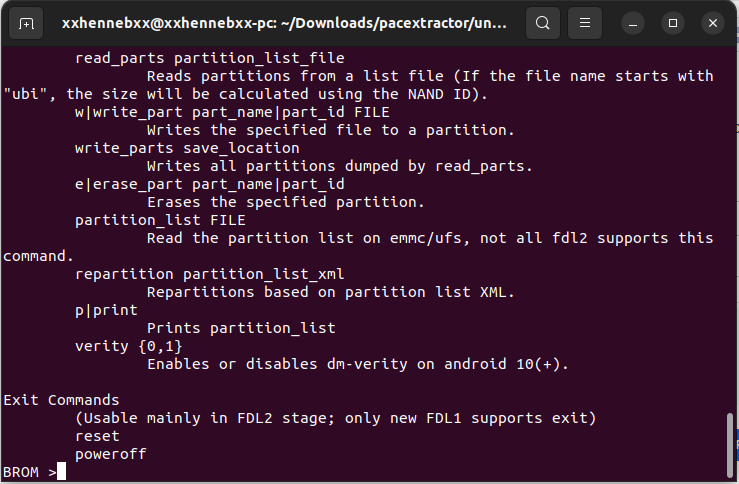

Come to the conclusion i was mistaken reading or even thinking what this was stating, so anyways, i used the gen_spl-unlock on my lk-sign.bin, which then output the patched file GREAT ! then i realised im supposed to boot into BootROM using the method stating in guide, i got to bootrom, but now i dont know what command it is to send to the bootrom using my newly patched lk-sign.bin..
i get the basic command to dump the firmware from device is "spd_dump --wait 300 fdl /path/to/fdl1 fdl1_addr fdl /path/to/fdl2 fdl2_addr exec path savepath r all reset"..
reading the help shows this command
"exec_addr [addr]
(brom stage only)
Sends custom_exec_no_verify_addr.bin to the specified memory address to bypass the signature verification by brom for splloader/fdl1.
Used for CVE-2022-38694.
would my new command be
spd_dump --wait 300 fdl /path/to/fdl1 fdl1_addr fdl /path/to/fdl2 fdl2_addr exec_addr custom_exec_no_verify_addr.bin [addr]  reset ?
would this be correct ? of course adjusting my file paths and addresses.  can i then flash vbmeta after to disable dm-verity or do i have to use script based within my line to add the option verity {0,1} is 0 off 1 0n also stated in the help as a command ?

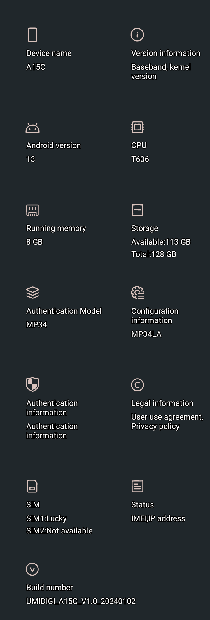

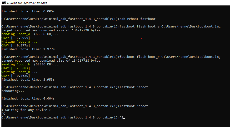

(11-01-2025, 05:20 PM)xXHenneBXx showing some photos of it being unlocked and the phone build for completed confirmation
