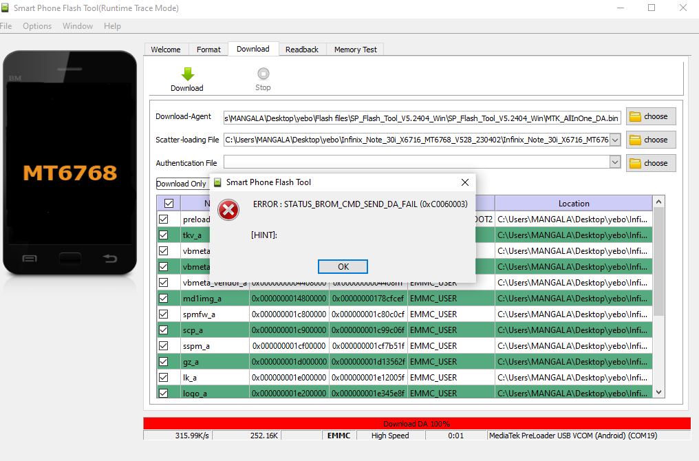

After flashing a wrong twrp recovery my infinix note 30i is in bootloop. its just going on and off. can't boot into recovery and can't switch it off. when i try to flash stock rom am getting an error with sp flash tool. i have tried most methods i have seen on the internet am getting nothing. please help anyone?

(12-12-2024, 12:14 AM)Arthuryebo After flashing a wrong twrp recovery my infinix note 30i is in bootloop. its just going on and off. can't boot into recovery and can't switch it off. when i try to flash stock rom am getting an error with sp flash tool. i have tried most methods i have seen on the internet am getting nothing. please help anyone?
Is the firmware you downloaded the same build as the one currently on your phone?
Did you flash TWRP to the Boot or Recovery partition?
Try using MTK Client to flash the stock boot.img or recovery.img
See @ https://www.hovatek.com/forum/thread-40866.html

i used fastboot to flash.

(16-12-2024, 07:33 PM)Arthuryebo i used fastboot to flash.
Alright, if you can still reboot to fastboot then flash back stock boot.img or use MTK Client as stated above
