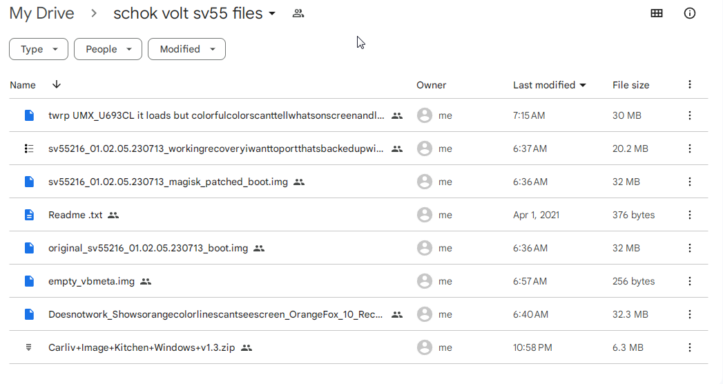

I trust this message finds you well. I am currently facing a critical technical issue and am reaching out for your expert guidance and assistance. After investing significant time and effort over the past 24 hours, I regret to report that I have been unable to successfully port the necessary files to the Team Win Recovery Project (TWRP) on my Schok Volt SV55 smartphone. These files are based on the UMX_U693CL model but require modification due to a severe display issue encountered with the twrp recovery, which manifests as a persistent blue display with lines and color malfunction.
The challenge I am facing arises from a potential incompatibility between the stock file system and the recovery environment. It appears that specific essential files, vital for a seamless transition to recovery mode, may either differ in nomenclature or be absent according to various online tutorials. This lack of critical transition data has left me bewildered, making it difficult to pinpoint the root cause of the issue.
To provide more context, I have attempted to utilize Orange Fox Recovery 11 on my Schok Volt SV55, originally based on the UMX_U693CL model. However, my efforts have been hampered by an unusual display anomaly. Upon launching Orange Fox Recovery, the screen displays severe distortions, characterized by a persistent orange hue colors.  So lets focus on the Twrp because the UMX U693CL kinda works. This issue may be linked to a display kernel driver malfunction, but given my limited expertise in this area, I lack the necessary knowledge to rectify it.
In light of the display challenge, I have attempted to locate an alternative TWRP for the Schok Volt SV55 model, originally based on the UMX_U693CL. Regrettably, the alternative recovery presents a blue display issue. Unfortunately, I am uncertain about the specific TWRP version that is compatible with my device, further complicating the resolution process.

Furthermore, I have included all relevant files, including the patched Magisk for this build. While root access has been successfully established, the TWRP file is available; however, display issues continue to pose a significant obstacle to progress. When the device is connected to a computer, it initiates a search for drivers, underscoring the necessity of resolving the blue display malfunction.

O my freaking #### i cant believe it i actually ported it myself Here you go people i used chat gpt to edit the default.prop file in hex lol hehehehehe
https://drive.google.com/file/d/1lSZQIH_xcyrAFzCfcNzylv5b5HBFAMoh/view?usp=drive_link
Ok there seems to be an issue in the fstab file because on twrp i goto backup and i have a 128gb memory card in it it says select storage sdcard (115412mb)
micro sd card (115412mb) I have to fix anyone stock

i used twrp from same display size and ported it that way

ok this is what i got

it loads into twrp but when it loads it has wronge name and it will not boot into system with it installed and heres the aik port and aik stock with the images in acordingly
https://drive.google.com/file/d/1eg10nbPYwbynpPupy8OnmVwwdJdmQAwc/view?usp=drive_link
