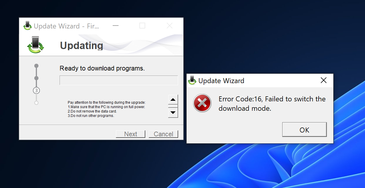

Hello everyone.
i got this device and it was locked, i managed to unlock it and it worked perfectly,
and i wanted to switch it from hilink mode to modem mode, i found some firmware (E3531s2_UPDATE_21.318.35.00.00) on the internet and i install it

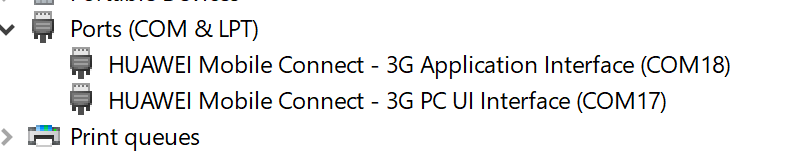

problem is i can see that the serialls ports are shown but i cant send AT COMMANDS neither access this ports or insatll another firmware. and when i try to install another firmware this message will show (Check joints)
pls someone show how to factory reset it or make these Serial port functional

you flashed firmware for e3531 to e3533. i wonder why though
try using dc unlocker tool - auto detect huawei, you should be able todetect the modem and run at commands
if so try AT^godload, then check if you're able to flash

thanks man it worked perfectly
