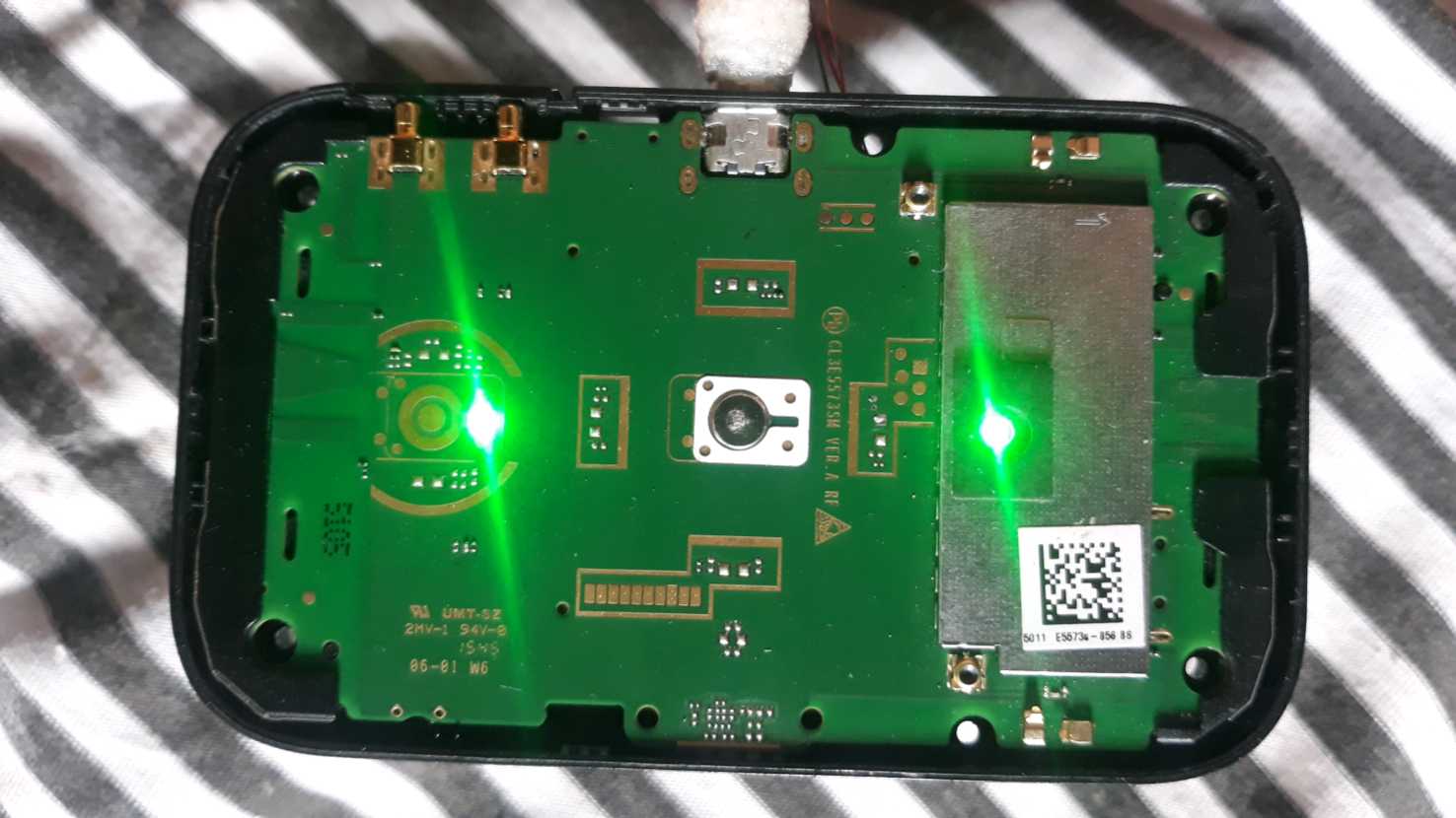

I have Huawei E5573s-856 mifi and i unlocked and debranded using Balong Usb loader.exe and E5573s-856_Update_21.315.15.00.00 v2.exe and all corresponding usb drivers. But after the Update message "device is rebooting" it turn the light to red and then I plug it out from usb and insert the battery then hold the power button but after boot the light is blinking 2 green only. Please help me. advance thank you guys.

you flashed usblsafe or usbloader?
when you connect the mifi to the pc when it's on and blinking the two leds, what is it detected as under device manager?
