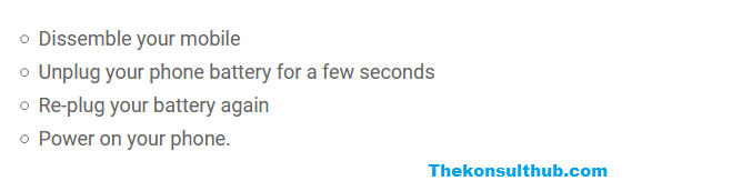

long-press the power button if it didn't turn on then you must have to loosen the phone and disconnect/reconnect the phone's battery.

Dissemble your phone first. You can refer to YouTube videos on how to. After, remove your battery for a few seconds and replug it again. It should start.
