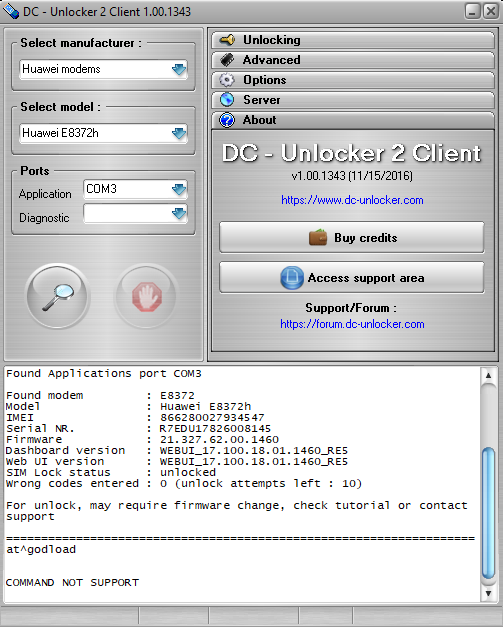

Here check screenshot, before unlocking at^godload command was working but after unlocking nothing is working. only at^reset command is working. by the way i unlocked it with "Telenor E8372H 21.328.62.00.1460 Unlocked_FW.rar" file.

(06-06-2019, 08:19 PM)nomanpezu Here check screenshot, before unlocking at^godload command was working but after unlocking nothing is working. only at^reset command is working. by the way i unlocked it with "Telenor E8372H 21.328.62.00.1460 Unlocked_FW.rar" file.
how did you manage to get godload command to work in order to flash the unlocked firmware? you should be able to repeat exactly the same steps you carried out before the unlock
and your modem is showing 21.327 when you unlocked using 21.328 , is that an error? maybe you used the 21.327

07-06-2019, 06:08 PM
(07-06-2019, 10:15 AM)freshtyt
I am following the same method i used before for unlocking but now it is not working. And i used the 21.328 because it was mentioned there that it is for both 21.327 and 21.328 versions firmware. i think it is because of that firmware, because it is of higher ver that's why at^godload command is not supported. I just need a solution to switch my device into download mode so that i can flash a lower version firmware.
08-06-2019, 09:06 AM
(07-06-2019, 06:08 PM)nomanpezu I am following the same method i used before for unlocking but now it is not working. And i used the 21.328 because it was mentioned there that it is for both 21.327 and 21.328 versions firmware. i think it is because of that firmware, because it is of higher ver that's why at^godload command is not supported. I just need a solution to switch my device into download mode so that i can flash a lower version firmware.
can't say for sure, afterall you previously thought at^godload doesn't work on the original firmware until you finally managed to get it to work so maybe there's something you're not doing right
try another dc unlocker version like latest version OR try putty, you need to search online how to configure and connect to putty
