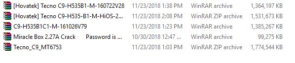

I just tried all the stock rom i downloaded today (6 different stock rom for tecno c9) none of it work and yet i used FORMAT ALL + DOWNLOAD and it successfully load but my phone is not still coming up... please help me, i gat no phone to use again
Admin come to my rescue pls....

I have downloaded this same rom with the same build number and i have install the rom but yet, my phone is not coming up. Dunno what else to do... am fed upĀ
Check the attachment for the file
