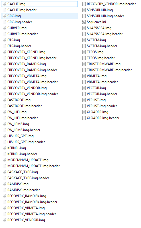

In attachment I added file list what are in UPDATE.APP file.

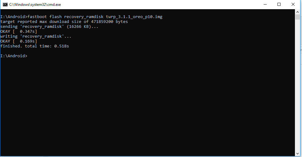

06-03-2018, 01:03 PM
I am not getting any error when I am flashing recovery. Everything is successful.
I am flashing TWRP for Oreo with command - "fastboot flash recovery_ramdisk TWRP.IMG"

(06-03-2018, 01:03 PM)Nauris Strazdins I am not getting any error when I am flashing recovery. Everything is successful.
upload full screenshot of adb window showing the cmds you sent and the error

06-03-2018, 08:35 PM
Here you go, but, as I said, I have no errors.

07-03-2018, 10:36 AM
(06-03-2018, 08:35 PM)Nauris Strazdins Here you go, but, as I said, I have no errors.
You should be able to flash the Oreo Update.app using DC Phoenix https://www.dc-unlocker.com/DC-Phoenix-f...r-tutorial unless you want to flash each partition one at a time via fastboot. recovery alone comprises of
recovery_ramdisk
recovery_vbmeta
recovery_vendor
erecovery_kernel
erecovery_ramdis
erecovery_vbmeta
erecovery_vendor
