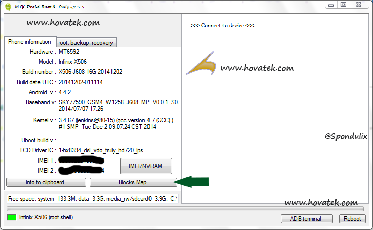

-- Run MTK Droid Tools.exe application as administrator
-- Once, device information is loaded successfully, click on Blocks Map to continue
[Image: How-to-create-Scatter-File-for-any-MTK-A...ices-1.png]

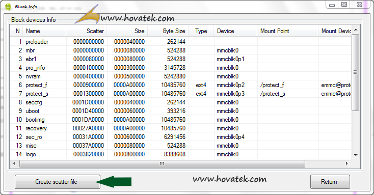

-- A new window will pop up, Now, you need to click on the Create Scatter File button.
[Image: How-to-create-Scatter-File-for-any-MTK-A...ices-2.png]
