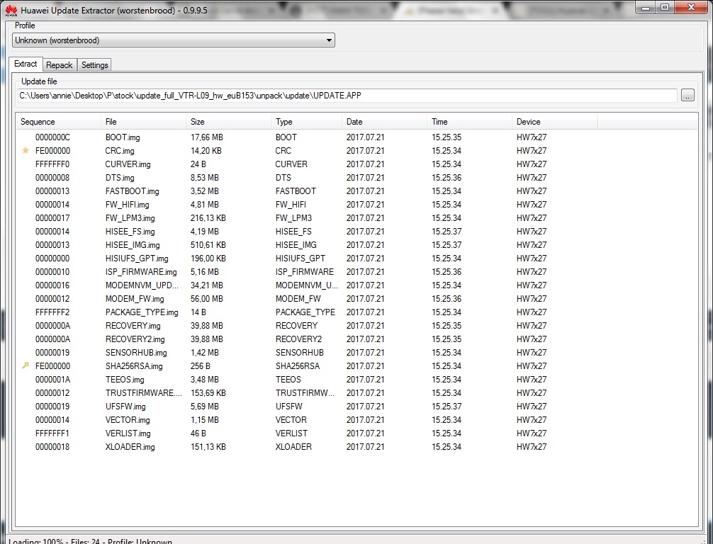

(22-09-2017, 09:21 AM)maxxxiii
(21-09-2017, 06:45 PM)Zerety TWRP . yes i have it. but i dont know which version was. thank you
Locking the Bootloader while you still had TWRP caused the Bootloop, you shouldn't have done that.
Download Update.app extractor from http://forum.xda-developers.com/attachme...id=3966156
and follow the instructions in https://forum.xda-developers.com/showthr...?t=2433454
I want to know the contents of the update.app
Sent from my Infinix X510 using Hovatek Forum
this ?  i think it was this one because the other update.app that the size over 1000kb cant be copy to SD when i tried to use them .  this one is the only one

(23-09-2017, 07:24 AM)Zerety this ?  i think it was this one because the other update.app that the size over 1000kb cant be copy to SD when i tried to use them .  this one is the only one
This is HiSilicon chip. You'll need either a box or to somehow find your way into fastboot to resolve this.
