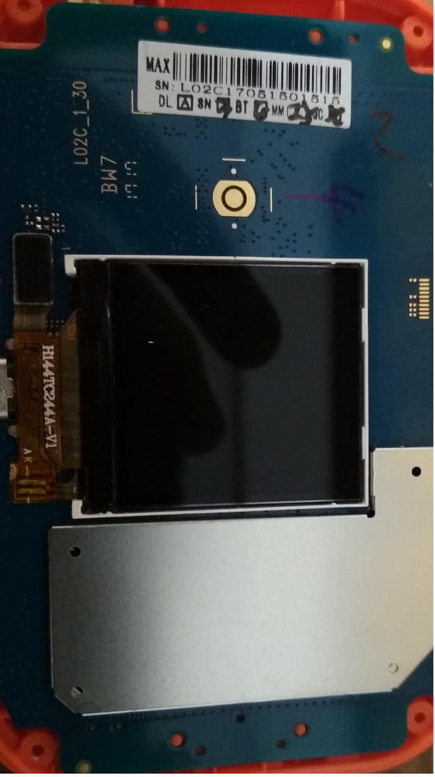

i use the same bolt mifi.
and this is the PCB board.
can U do something about it? Sad

Use imei metode, you use bolt aquila max, isn't!

(28-09-2017, 12:47 PM)asep_one1 Use imei metode, you use bolt aquila max, isn't!
Sent from my Lenovo A7000-a using Tapatalk
can u tell me what is is imei method?? do i need to download other program?

(27-09-2017, 01:14 AM)barzel
Bro, to unlock device using this IMEI approach
Device must meet the following dashboard(WEBUI) features
In Network Mode should have 3G, 4G and LTE only
It may not work on supported on 4g only mode
Review WEBUI...

(29-09-2017, 08:40 AM)droidmobitech
Review WEBUI...
is there any other approach other than imei method?
or can we change the WEBUI software?
