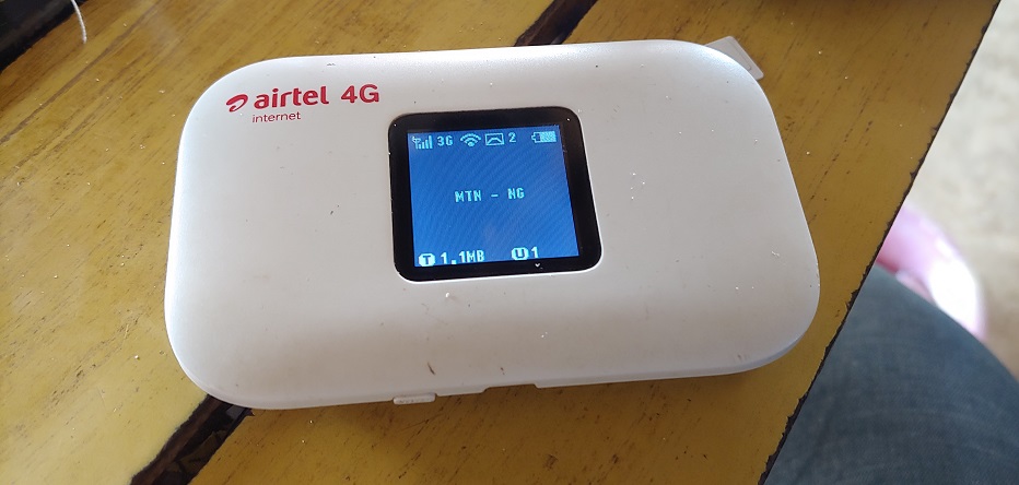

30-03-2021, 11:47 AM
Maybe this is late but if you are experiencing the WTPTP Error: FBF_VersionNotMatch error, it's due to two things, either you've flashed the wrong firmware before or your board is incompatible with the firmware you want to flash.
The first case is my own case, I flashed the firmware of M028T on M022T, everything works just fine not until I noticed that no sim card is discovering the network, so here is how I managed to fix this;
Flash the first Uganda version, make sure you select "PRODUCTION MODE" and "ERASE ALL"
Quickly remove the MiFi after erasing it (before writing the firmware)
Try to power it on, if everything goes on well, the MiFi SHOULDN'T BOOT
Open the new and compatible firmware
flash it again but with ERASE ALL selected ONLY
Try this and thank me later
if you are still experiencing the same issue, you can send a DM on Whatsapp; +2348146800602
This post was last modified: 30-03-2021, 11:55 AM by Dewale223.
