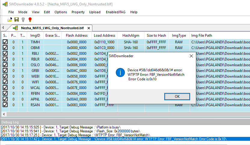

30-10-2017, 12:34 PM
#76
After proceeding to the next step 7, i get an error, please refer to the image attached.
droidmobitech
droidmobitech
droidmobitech
828
30-10-2017, 12:38 PM
#77
(30-10-2017, 12:34 PM)frankjose256 After proceeding to the next step 7, i get an error, please refer to the image attached.
Repeat the step 6 again, this time do not disconnect so early about 10-12% or erase flash complete, then disconnect.
This time it should proceed without error in the next step

30-10-2017, 12:59 PM
#78
(30-10-2017, 12:38 PM)droidmobitech
You guys are awesome, it worked like a charm, keep up the good work.
