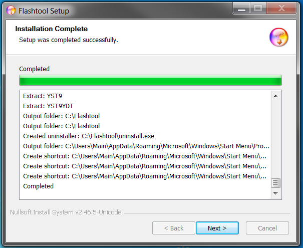

* First install your drivers then install flashtool
[Image: flashtool-installation-1.png]
[Image: flashtool-installation-2.png]
[Image: flashtool-installation-3.png]
[Image: flashtool-installation-4.png]
[Image: flashtool-installation-5.png]

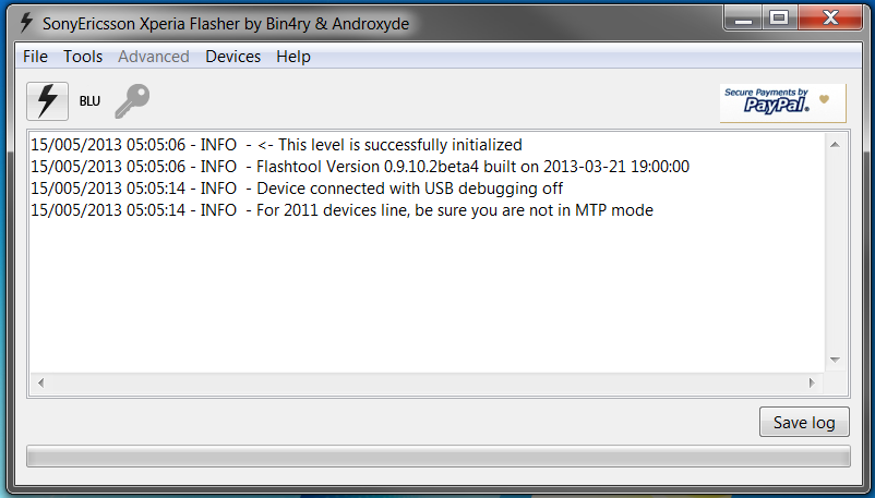

* Launch flashtool
[Image: sony-xperia-flashtool-1.png]
