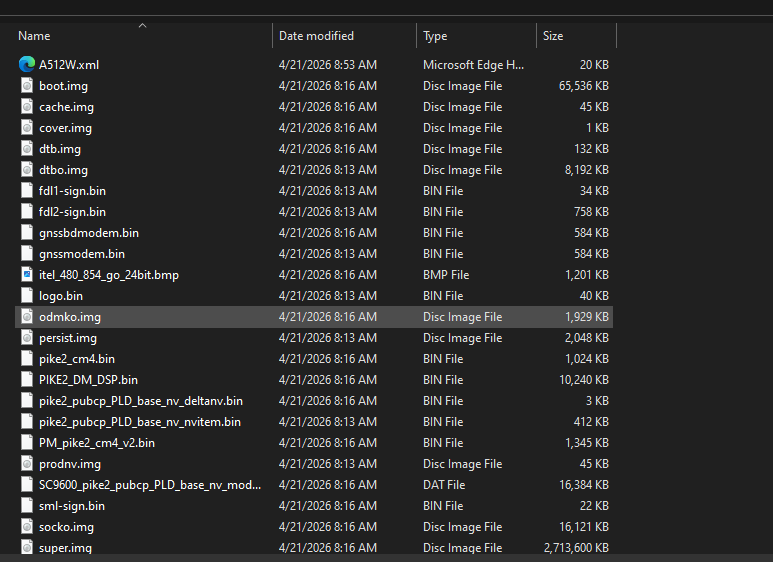

I’ve tried flashing the stock ROM and stock VBMeta image using multiple versions of the SP Research Download Tool and Upgrade and Factory tools, but nothing works. After downloading fdl1-sign.bin and fdl2-sign.bin, some tools give an "Input Time" error after 32 seconds, while others throw an "Incompatible Partition" error. I've installed the correct drivers and have the exact ROM version for my device. I've even tried multiple versions of the Itel A18 ROM, but the same errors continue to occur.
