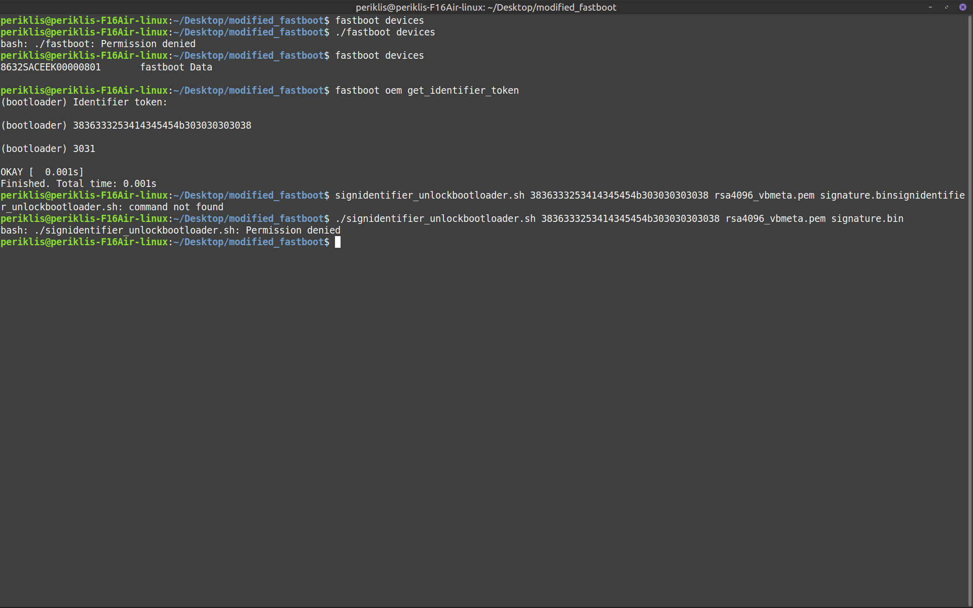

It is a unisoc tablet. Googling and searching showed earlier models could be unlocked. This one looks impossible.
 .pac file is available from teclast, I extracted the boot.img and tried the easy magisk procedure and every other way I found online.
Hovatec`s way gives this. Any possible help will be highly appreciated.

(14-06-2025, 08:58 PM)6p6eimedr It is a unisoc tablet. Googling and searching showed earlier models could be unlocked. This one looks impossible.
Hovatec`s way results next picture . Any possible help will be highly appreciated.

20-06-2025, 02:39 PM
(14-06-2025, 08:58 PM)6p6eimedr It is a unisoc tablet...
Check this https://github.com/TomKing062/CVE-2022-3...bootloader
