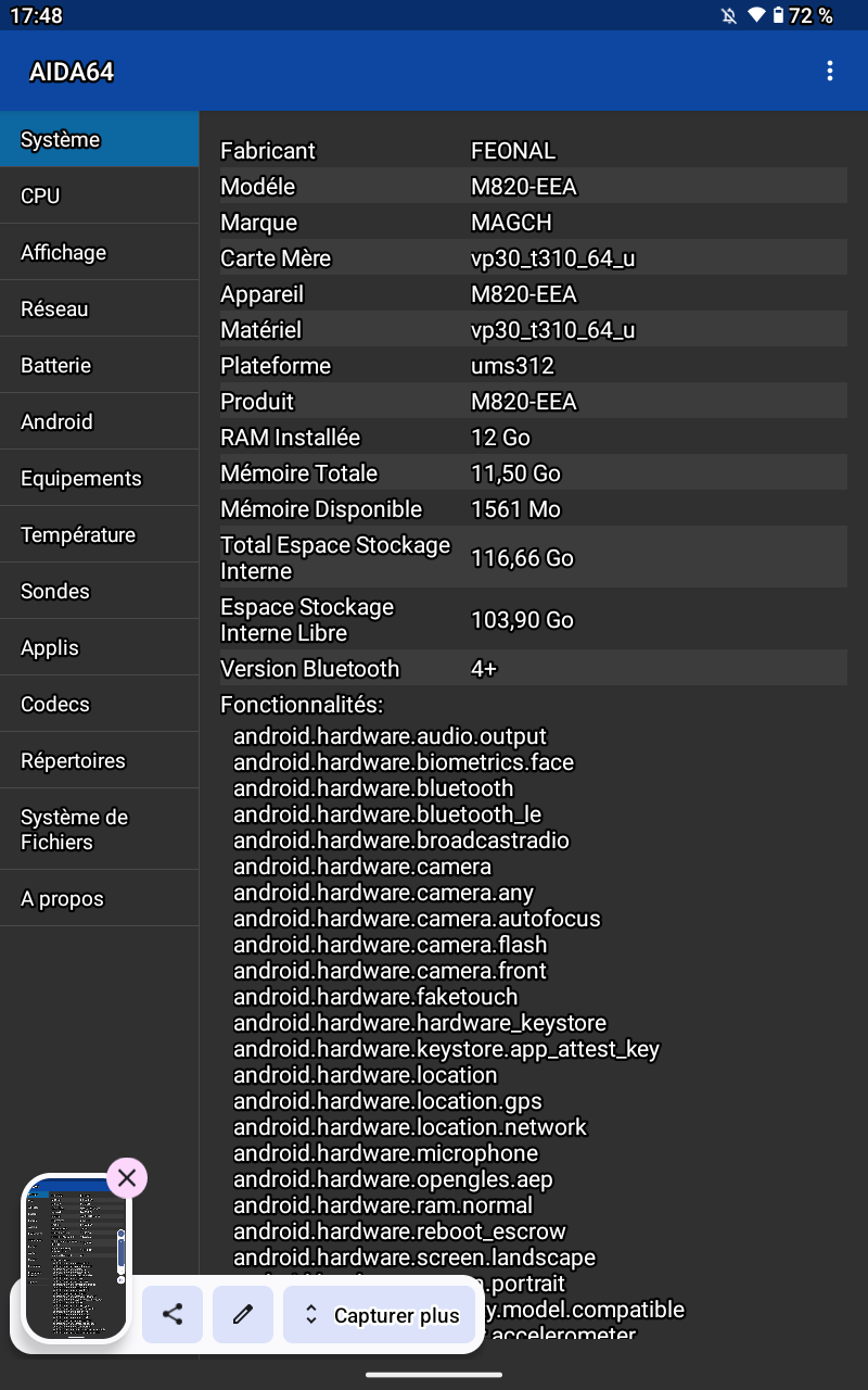

31-12-2024, 05:46 PM
here two screenshots by AIDA64 :
THANKS

(31-12-2024, 05:46 PM)Amar13 here two screenshots by AIDA64 :
THANKS
Your best shot is https://github.com/TomKing062/CVE-2022-3...bootloader
Maybe you can dump your firmware with spd_dump

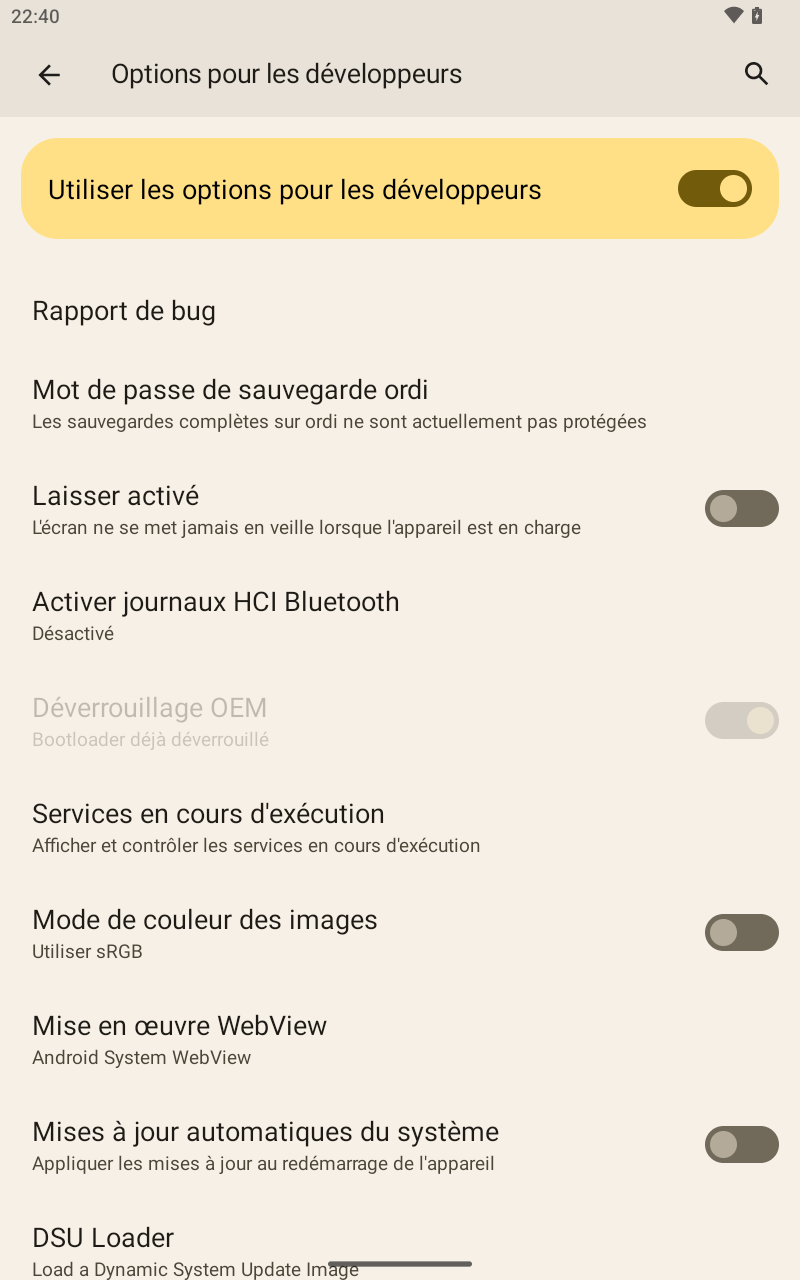

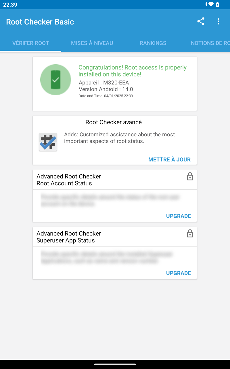

04-01-2025, 11:53 PM
(01-01-2025, 03:08 PM)maxpayne
THANKS
Thank you very much for your link, thanks to you and your forum, I managed to unlock the bootloader and root the tablet !
