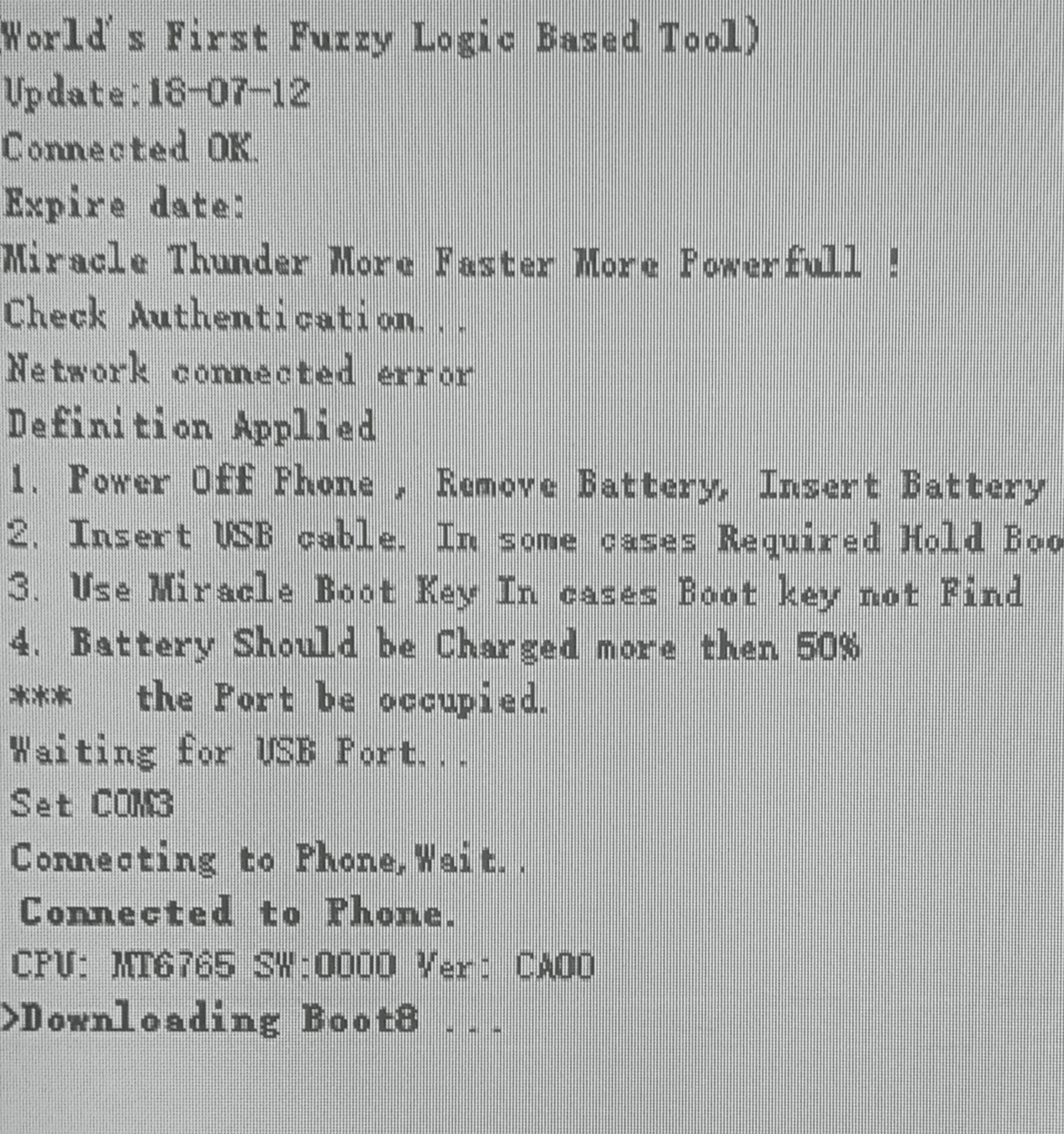

Hello hovatek... I tried reseting FRP using miracle box method as it seems to be the easiest but it gets stuck at downloading boot8. What's the cause and what's the fix?

(26-11-2024, 05:38 AM)jdfm Hello hovatek... I tried reseting FRP using miracle box method as it seems to be the easiest but it gets stuck at downloading boot8. What's the cause and what's the fix?
You can use MTK Client or the combination of MTK Client+ SP Flash Tool to format FRP partition
https://www.hovatek.com/forum/thread-46342.html
https://www.hovatek.com/forum/thread-21638.html
