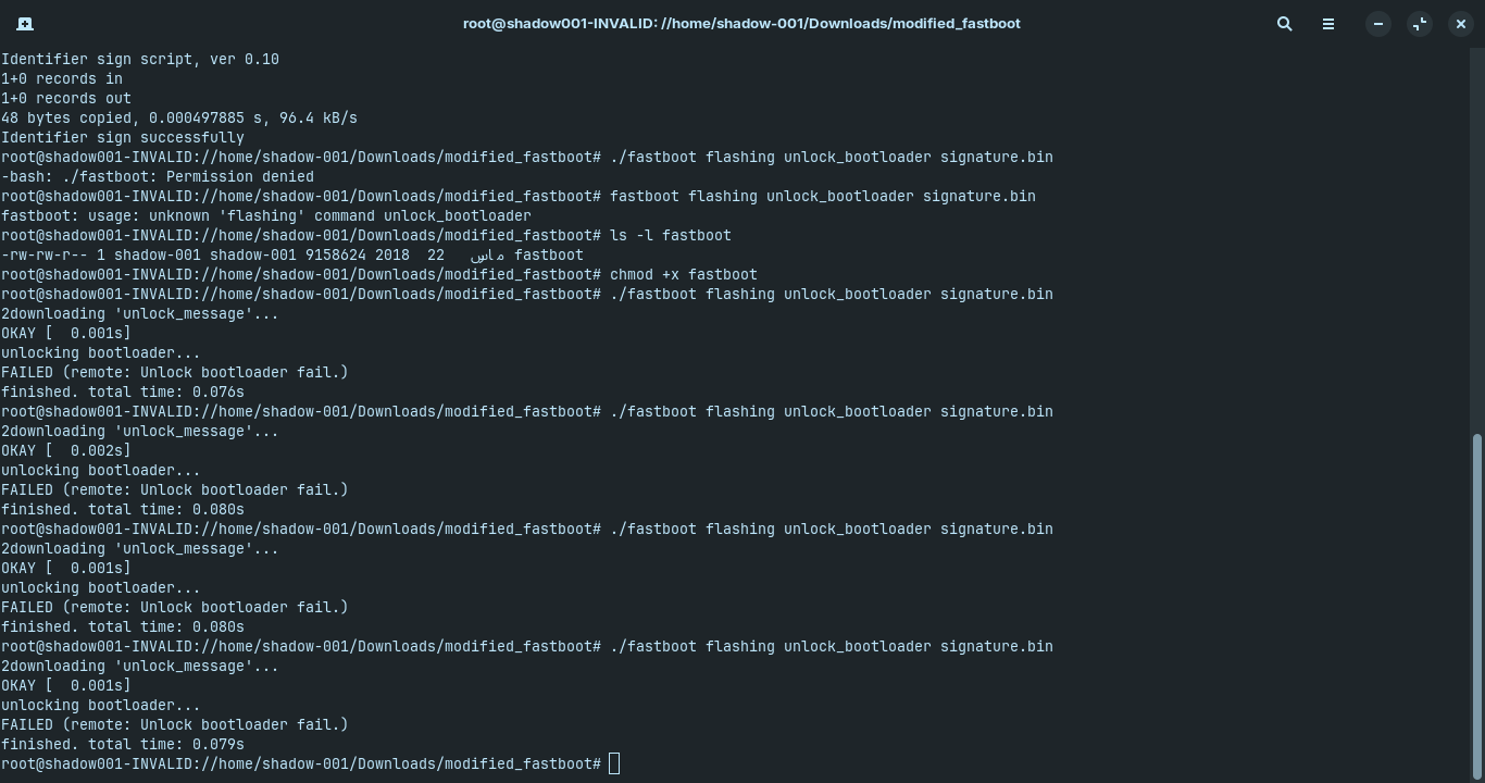

sir il stuck at the final step befor unlock my bootloader this what i see after
./fastboot flashing unlock_bootloader signature.bin

(18-11-2024, 03:59 PM)Qraa2005 sir il stuck at the final step befor unlock my bootloader this what i see after
What's the device model?

Its Infinix smart 8 (X6525)

(19-11-2024, 07:30 PM)Qraa2005
(19-11-2024, 05:57 PM)justshez
Refer to https://github.com/TomKing062/CVE-2022-3...oader/wiki
