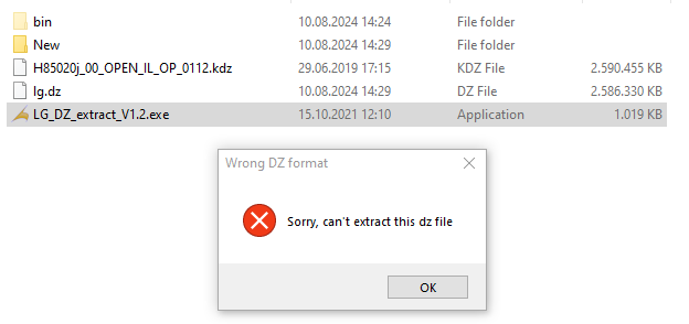

Sadly this tool doesn't extract the dz, I've tried it multiple times (and also tried v1.0.) Maybe there's something wrong with the G5's stock rom specifically.
