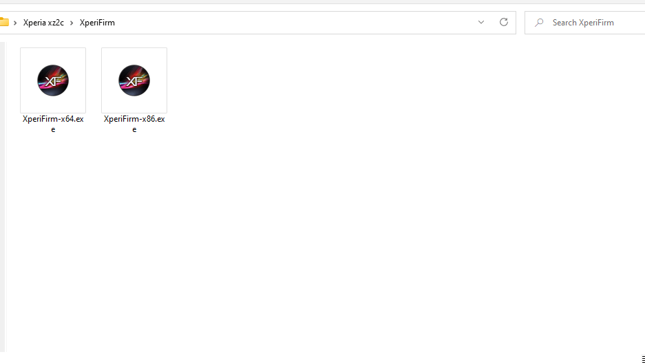

- Download and extract the latest version of XperiFirm.

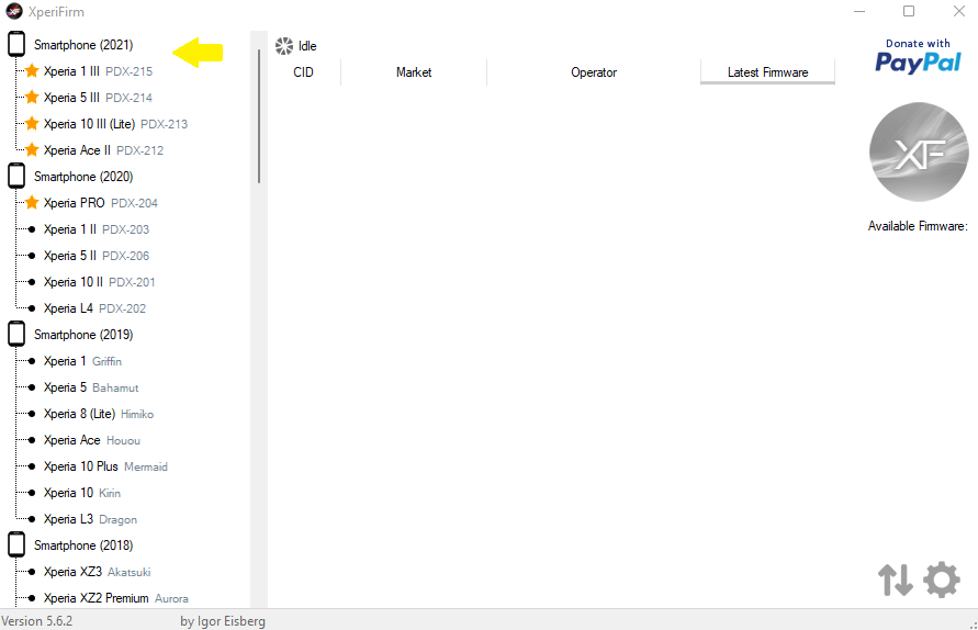

- Now, double-click on the XperiFirm icon to launch it. Then you'll be able to see the following screen.
- With the device Models listed on the left side.

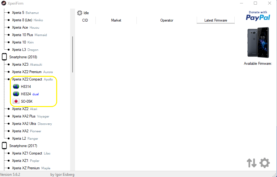

- Now, choose your device by clicking on the name. Automatically you should see the list of Variant Numbers.

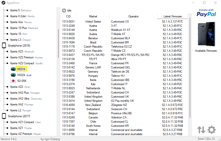

- Now, select the correct Variant Number of your device, It will display the List of Available Firmware based on Region/Carrier.

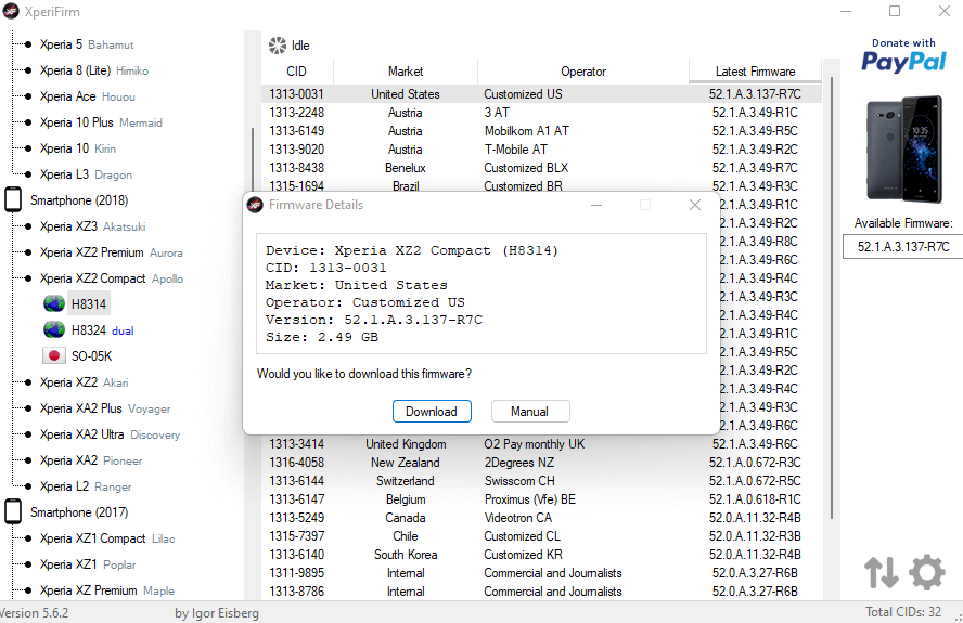

- You can then choose the Firmware for your Region/Carrier. Then click on the Available Firmware.
- It will open a dialog box showing the Firmware details, Then click on the download button to begin downloading the Firmware.
