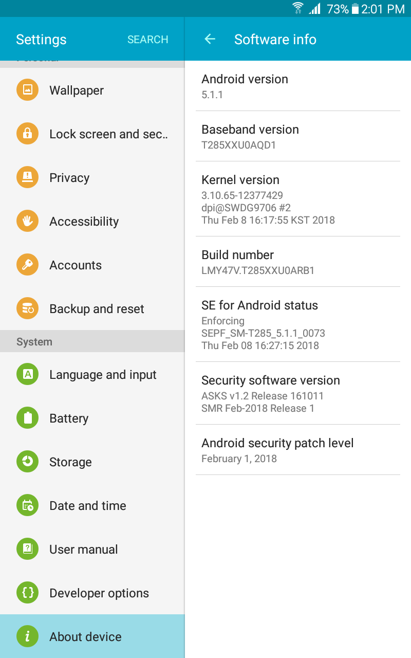

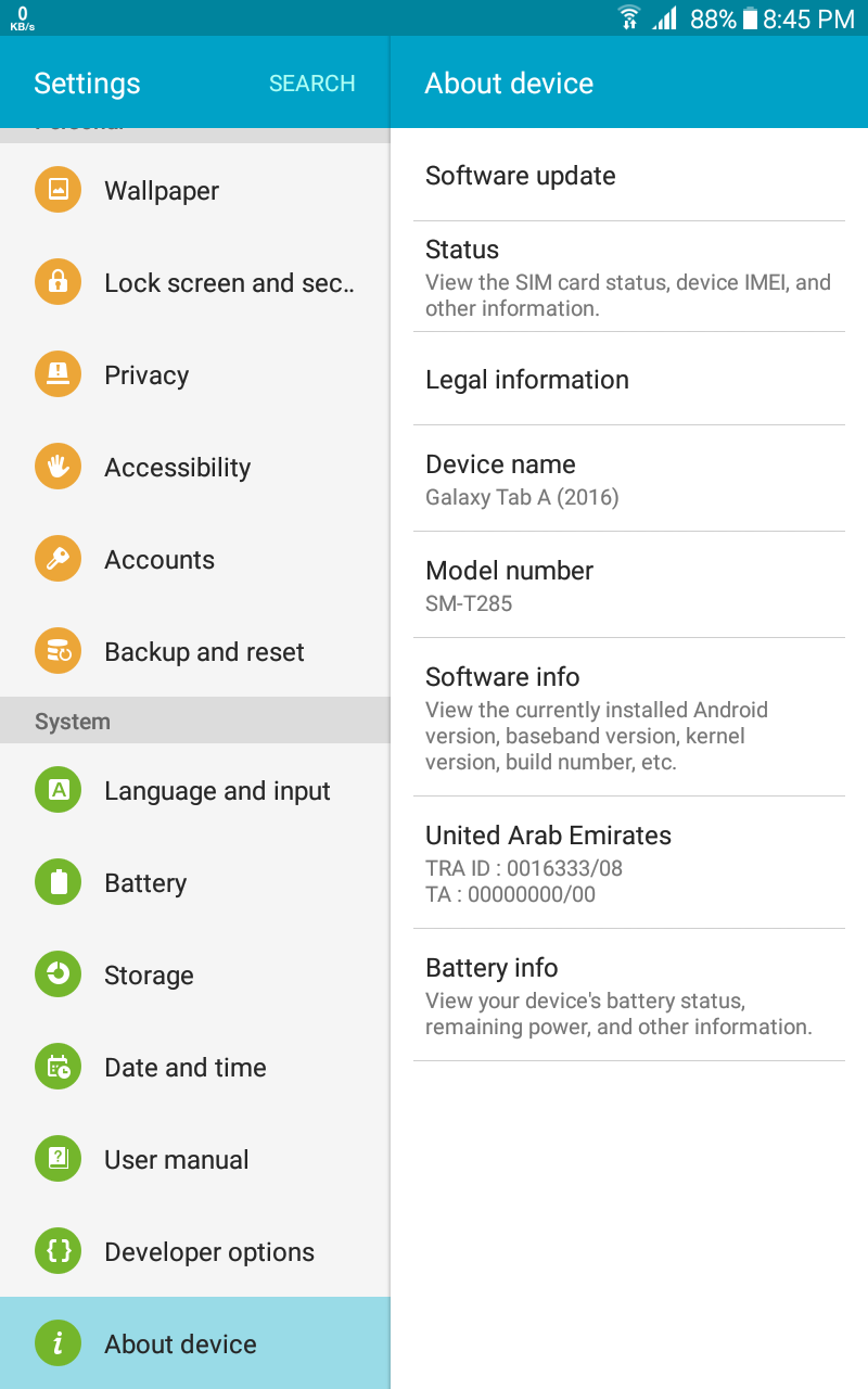

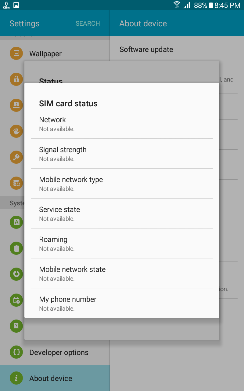

Hello
My Samsung Galaxy tablet detects sim cards when I insert sim card it tells me to Restart the device to access mobile network which I do. After restarting it shows No Sim Card | Emergency Calls Only in status bar and the sim is working perfectly fine in other device. Please help cause I have tried factory reset and also flashed the latest firmware by Odin. it still doesn't work
Thanks

how did this problem begin?
is the baseband unknown? is the imei invalid?
did you cover the sim port properly?

I don't know how it began, the baseband is not unknown and the IMEI is valid. I have covered the sim port properly.

Yes, I have been using SIM on this tab before this started. These sceanrios does not apply here
1. It's not network locked tablet. I have tried putting different SIMs.
2. Not Incompatible firmware. I had not flashed anything before I had this problem then I flashed stock rom.
3. Not Damaged SIM slot. How come it detects when a SIM card has been inserted in the sim slot.
4. Network mode is set to Auto and I can't change it.
Can someone look at the service mode *#0011# attached screenshot if there is a problem. Nothing changes in it when I insert or remove the sim card.
