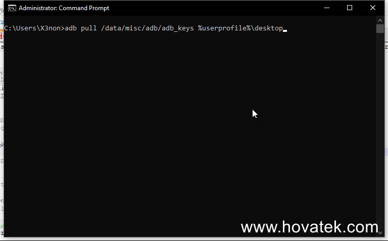

  1. Launch an adb window and type the command below (this will copy the file adb_keys from your phone to your desktop)
    adb pull /data/misc/adb/adb_keys %userprofile%\desktop

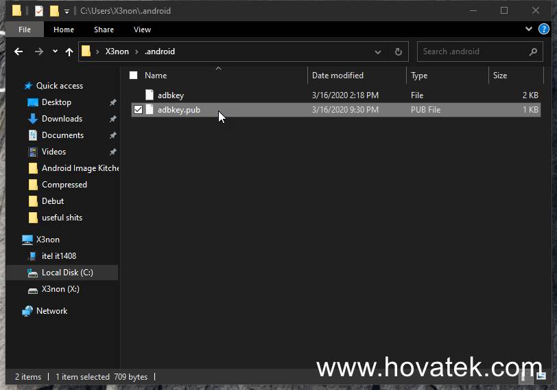

  3. On your PC, navigate to the folder location below to find adbkey.pub
    • On windows, the file adbkey.pub can found at the location %userprofile%\.android\
    • On linux, the file adbkey.pub can be found at the location ~/.android/

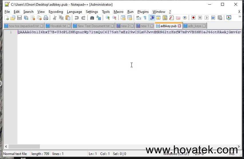

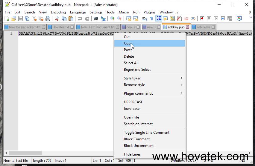

  5. Copy out the entire contents from adbkey.pub file (shortcut keys Ctrl A then Ctrl C)

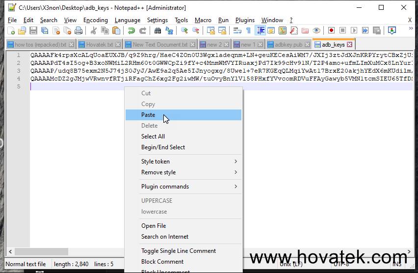

  6. Paste the contents into a new line within the adb_keys files then save
