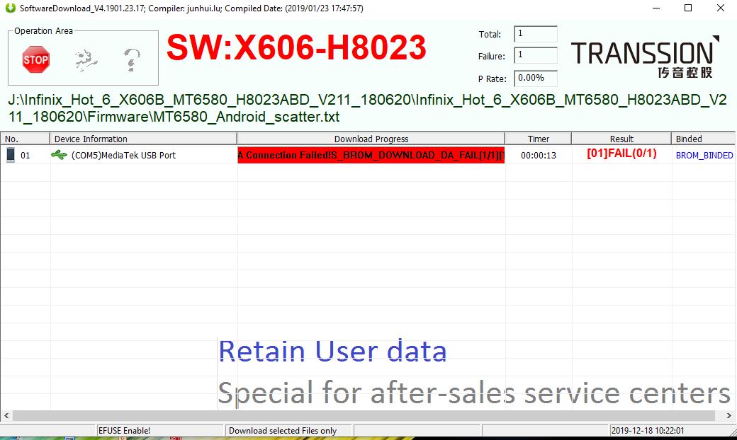

I formatted all flash on my infinix Hot 6 X606B. Now ave been trying to download new firmware using SP flash tool and SoftwareDownload but all in vain. Sp Flash tool shows Security error and Software Download shows the error indicated on the screenshot attached. Anyone with an idea on how I can go through this???
Please

18-12-2019, 10:43 AM
(18-12-2019, 07:11 AM)BTS I tried using format all + Download but the Software Download say that I must have a dongle for the Function to work
latest version will require a dongle to use format all + download, use other versions other than the latest version
