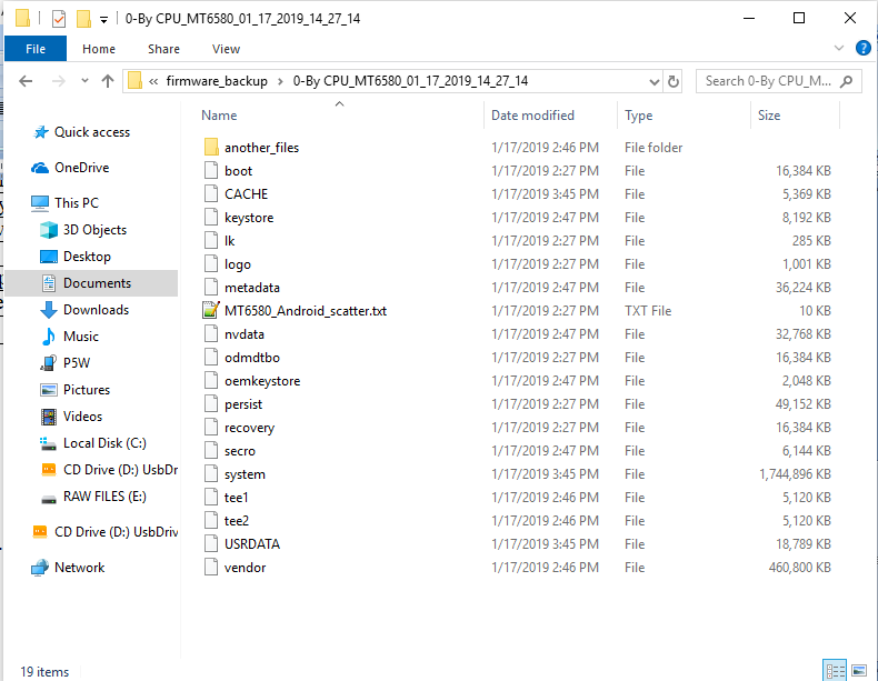

I have been able to backup using NCK MTK but the file has no extension, is it normal?

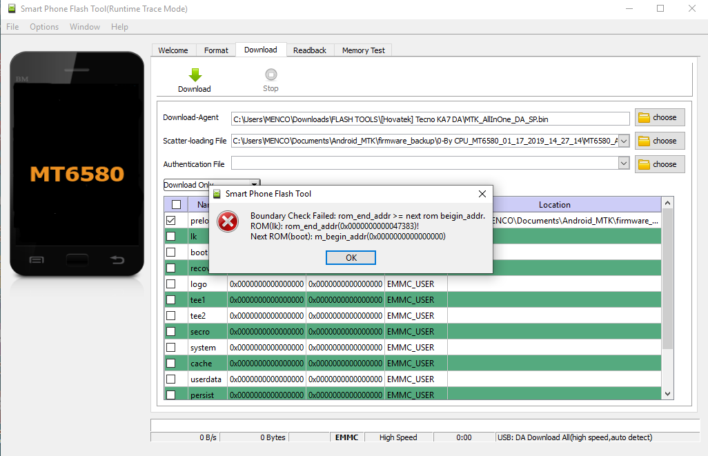

After backup with NCK MTK, I tried loading the scatter file with SPft, but i got an error message

17-01-2019, 07:48 PM
Use the wwr method you were onto before, leave out user data and cache as X3non suggested, and make sure you have uninterrupted power supply.
Most times, its not possible to flash back NCK readback, unless you were careful about it and use NCK for the flashing.
18-01-2019, 10:46 AM
(17-01-2019, 06:43 PM)mencoronaldo After backup with NCK MTK, I tried loading the scatter file with SPft, but i got an error message
use the same nckbox to flash this
