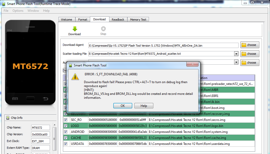

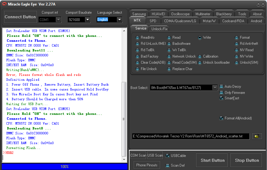

02-05-2018, 08:13 AM
I used miracle box to dump the phone's firmware and also used the same and SP Tools to try and write the new rom builds. As for the errors i have attached screenshots of errors in both sp tools and miracle box.

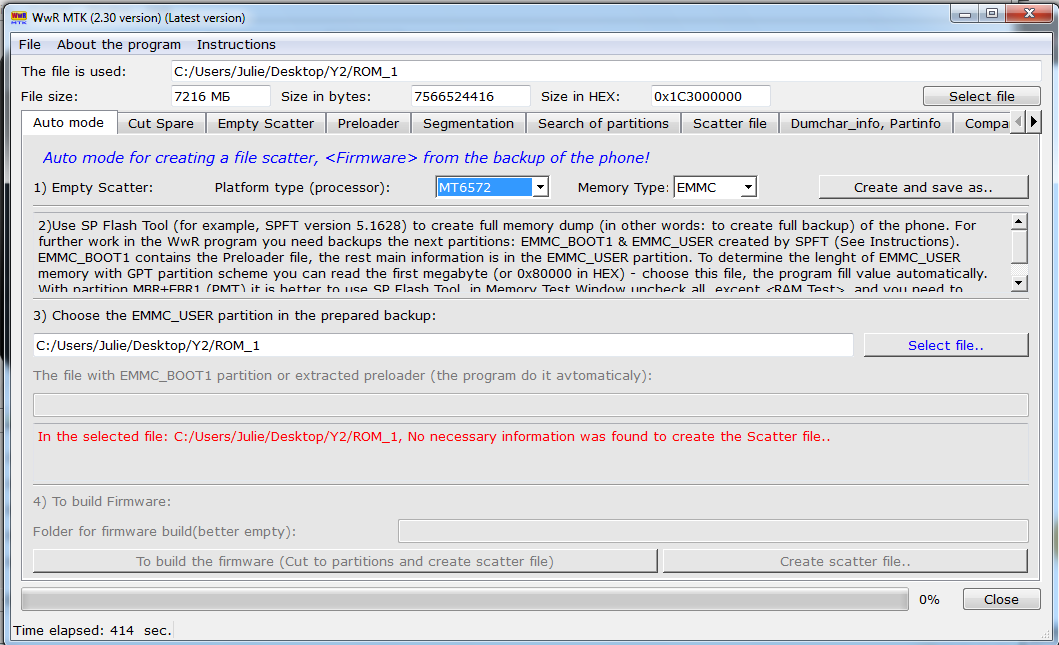

Attach screenshot of the contents of the firmware let's took a look.

02-05-2018, 04:01 PM

02-05-2018, 04:02 PM
Attached above as requested.
