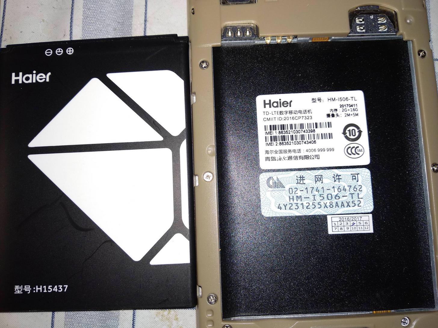

Essentially, i replaced the boot.img with the patched boot image (from Magisk) and downloaded that.. then i, for reasons probably to do with panic, kept downloading different combinations of the scatter because it would not turn on at all and would only respond if i held down vol+ with POWER before clicking download (in the SP Flash Tool)
I will try to get the build number as @innagee suggested
Edit:
Only 1 method for getting the build number will work; motherboard check - is it perhaps indicated in the image?
Edit:
I was mistaken to guess "3 builds," i meant 3 firmware versions... is there anyone who could link me the different Haier-i506-TL firmwares so I can try downloading all of them onto the phone?

11-05-2018, 05:09 PM
(11-05-2018, 11:20 AM)buser111 Essentially, i replaced the boot.img with the patched boot image (from Magisk) and downloaded that.. then i, for reasons probably to do with panic, kept downloading different combinations of the scatter because it would not turn on at all and would only respond if i held down vol+ with POWER before clicking download (in the SP Flash Tool)
Edit:
Edit:
Thank you
where you able to successfully flash patched_boot.img or it ended with an error?
whats the current state of the phone? [totally dead or stuck at boot]
how many firmwares for this model have you downloaded and tried flashing?

12-05-2018, 08:35 AM
(11-05-2018, 11:20 AM)buser111 Only 1 method for getting the build number will work; motherboard check - is it perhaps indicated in the image?
I think Miracle Box should work. What's your phone's chipset (i.e MT****)
