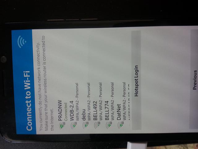

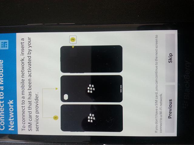

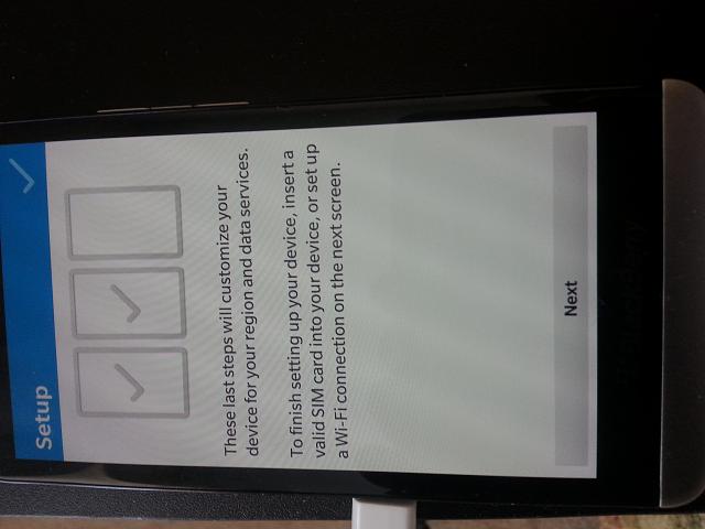

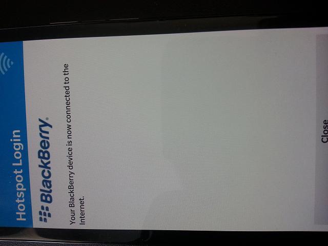

Please help me with  blackberry Z30. Phone boots is stuck after connecting to wifi hotspot. Please see images.

(23-04-2018, 01:04 PM)Adonso Please help me with  blackberry Z30. Phone boots is stuck after connecting to wifi hotspot. Please see images.
Reboot the phone and retry the process.
Also, make sure the WiFi you use has internet access.

24-04-2018, 08:54 AM
(23-04-2018, 04:47 PM)innagee
I have tried several times. the result is the same.

24-04-2018, 02:54 PM
(24-04-2018, 08:54 AM)Adonso
Did you try with another wifi network?
Have you tried flashing the phone?

24-04-2018, 03:26 PM
(24-04-2018, 02:54 PM)innagee
Please how do I flash a blackberry?
24-04-2018, 03:27 PM
Reload the OS using Blackberry Link

24-04-2018, 03:34 PM

24-04-2018, 04:23 PM
(24-04-2018, 03:34 PM)Adonso
(24-04-2018, 03:27 PM)juvette
Sent from my Infinix X510 using Hovatek Mobile
Any tutorial available please?
download the firmware (autoloader) @ https://depositfiles.com/files/804xnjglk
then follow the guide @ https://www.hovatek.com/blog/how-to-load...utoloader/ to flash the firmware.

25-04-2018, 08:47 AM
(24-04-2018, 04:23 PM)innagee
Thanks
