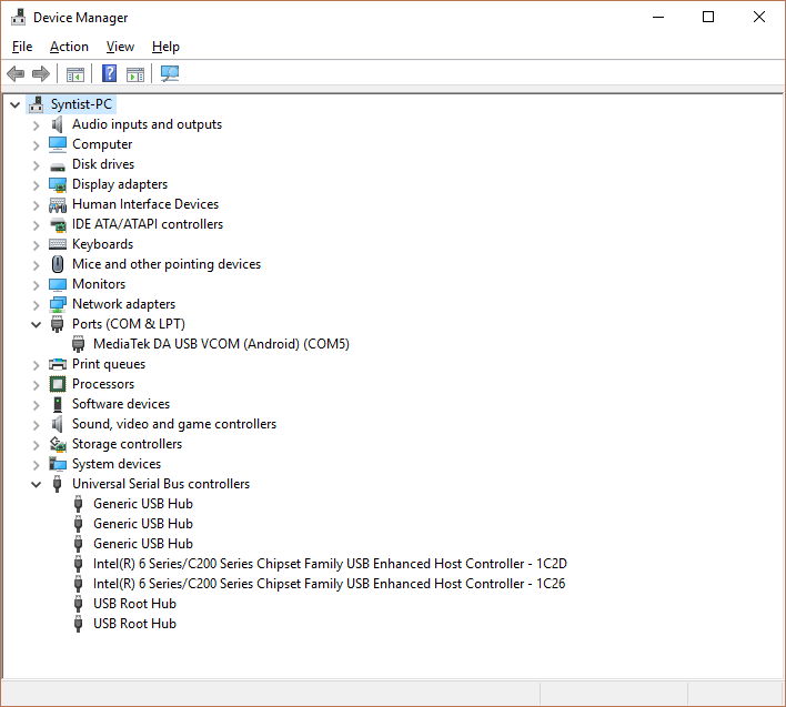

I can't really get the battery out, because its covered.
Was trying to install TWRP Recovery, and somehow my phone got brick Sad
It does connect to my pc even if its dead.
I got the stock rom, just wanna re-flash it Sad
Plz Help....

don't flash anything yet
how did you attempt to flash TWRP?
and how exactly did the device go dead in the first place?

Actually, I re-flash my stock rom and tried to flash twrp...
When ever i flash twrp and try to turn on recovery mode (power+volume up) just after flashing twrp.
My phone restart and goes back to normal boot.
And than when i enter recovery it was stock recovery
I tried many time, re-flash try to get twrp working, it was working before flashing the stock rom.
My Mobile before getting dead, i flash twrp and mistakenly closed the program it hanged and than my mob didn't bootup.
Edit: Was flashing using SP Flash Tool.
The Stock Rom Firmware i got, It's working and Tested Smile

It sounds like an interruption/drained battery issue.
Try the fix @ https://www.hovatek.com/forum/thread-808.html (though you'll have to loose and takeout/reinsert the battery).

I have opened the back of the mobile, but couldn't get the battery out. Sad
Any way to disconnect it?
Edit: I got it, Flashing again, and its working.
I don't know if i should try to flash recovery again?
