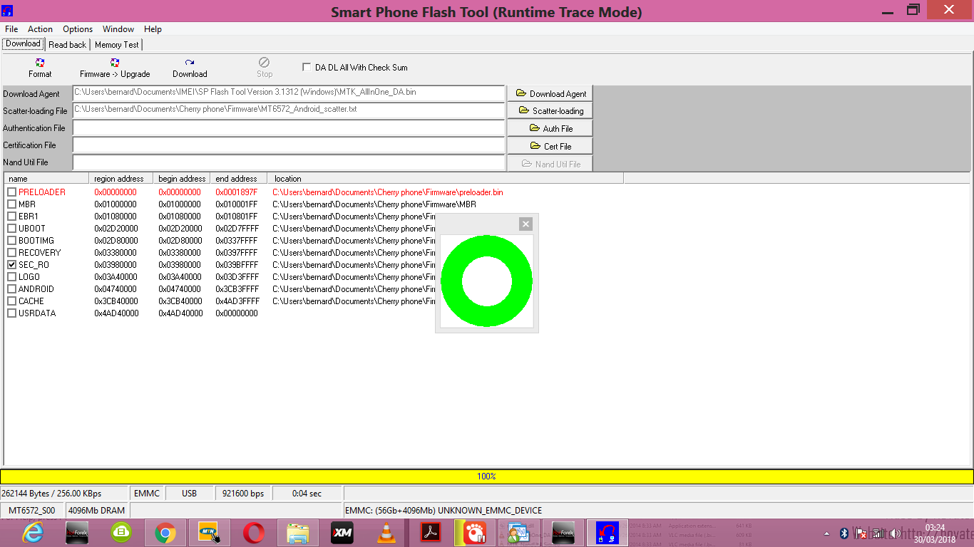

flashed the phone but now can not boot. Not sure what really went wrong. Here is what i did and could not get download okay massage.

(30-03-2018, 03:00 AM)Bernard Chongo flashed the phone but now can not boot. Not sure what really went wrong. Here is what i did and could not get download okay massage.
It seems like the download was successful.
Take out/reinsert the battery then try powering it.

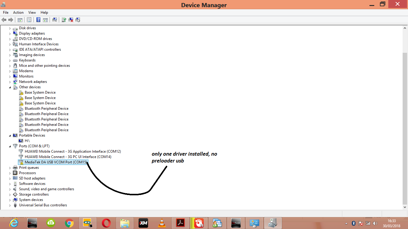

I noticed that media tek Preloader usb vcom driver is not installing on my pc. Only media tek DA USB VCOM. can be  seen. could that be the reason I did not get the download okay and fail to boot after flashing secro. Tried reinstalling the vcom drivers but only DA USB VCOM is appearing. what else can I do. I am using 32bit pc. Please help.

(30-03-2018, 03:59 PM)Bernard Chongo I noticed that media tek Preloader usb vcom driver is not installing on my pc. Only media tek DA USB VCOM. can be  seen. could that be the reason I did not get the download okay and fail to boot after flashing secro. Tried reinstalling the vcom drivers but only DA USB VCOM is appearing. what else can I do. I am using 32bit pc. Please help.
your phone is dead due to interruption, either loosen the phone and disconnect / reconnect the battery OR keep charging till it powers on
refer to https://www.hovatek.com/forum/thread-808.html
for the driver issue, doesn't matter if you are using 32bit and you only need one driver
uninstall all mtk drivers using usb deview @ https://www.hovatek.com/forum/thread-7660.html
reinstall vcom preloader driver using the guide @ https://www.hovatek.com/forum/thread-440.html
