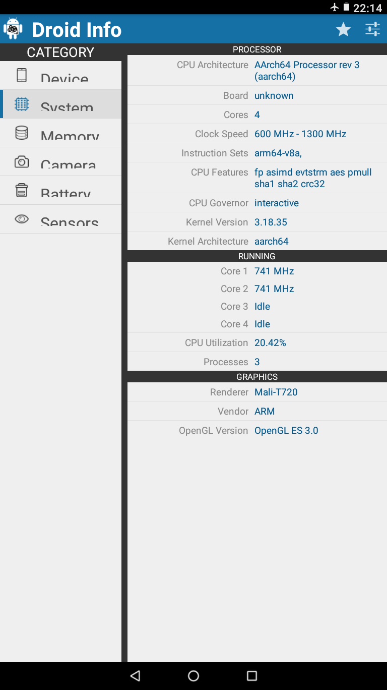

verify the chipset of your device using the app @ https://www.hovatek.com/forum/thread-13054.html
also attach a screenshot of the error message you get when you attempt flashing patched_boot
