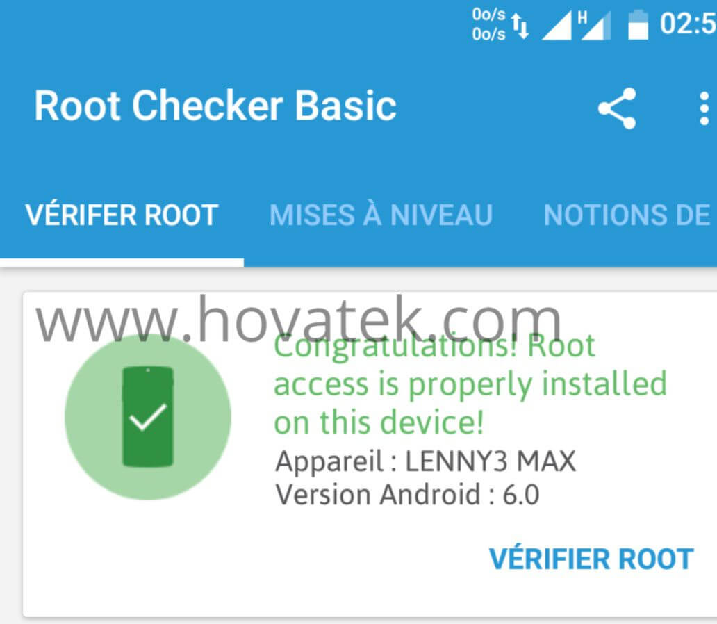

Confirm Root by installing and running Root Checker
