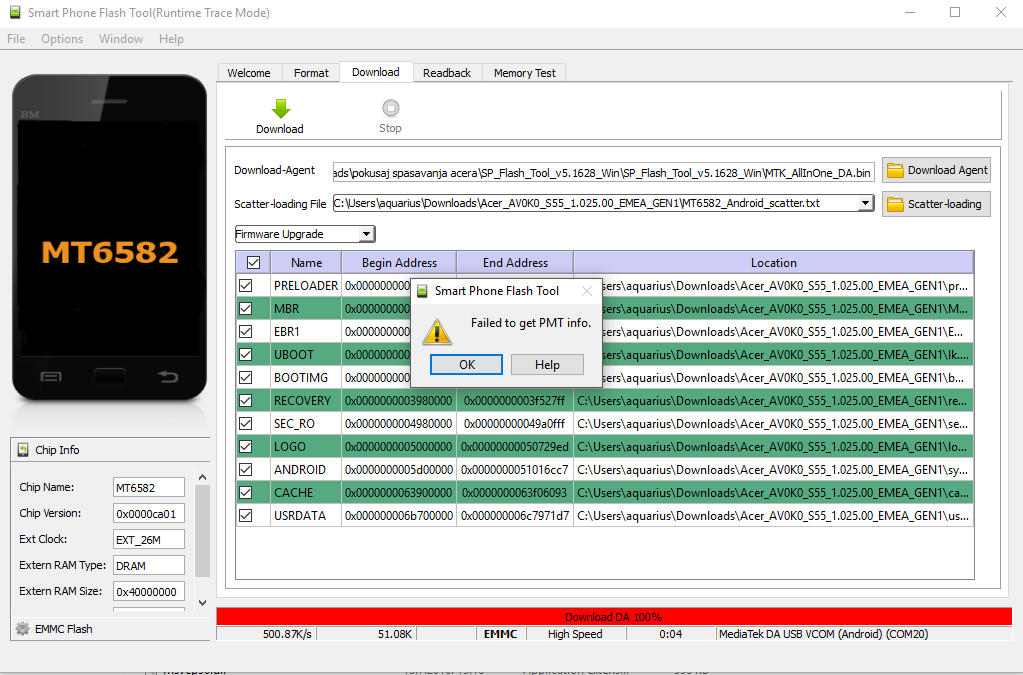

Tried firmware upgrade with different versions of the tool and of the firmware. Most of the times I get "Failed to get PMT info." error:

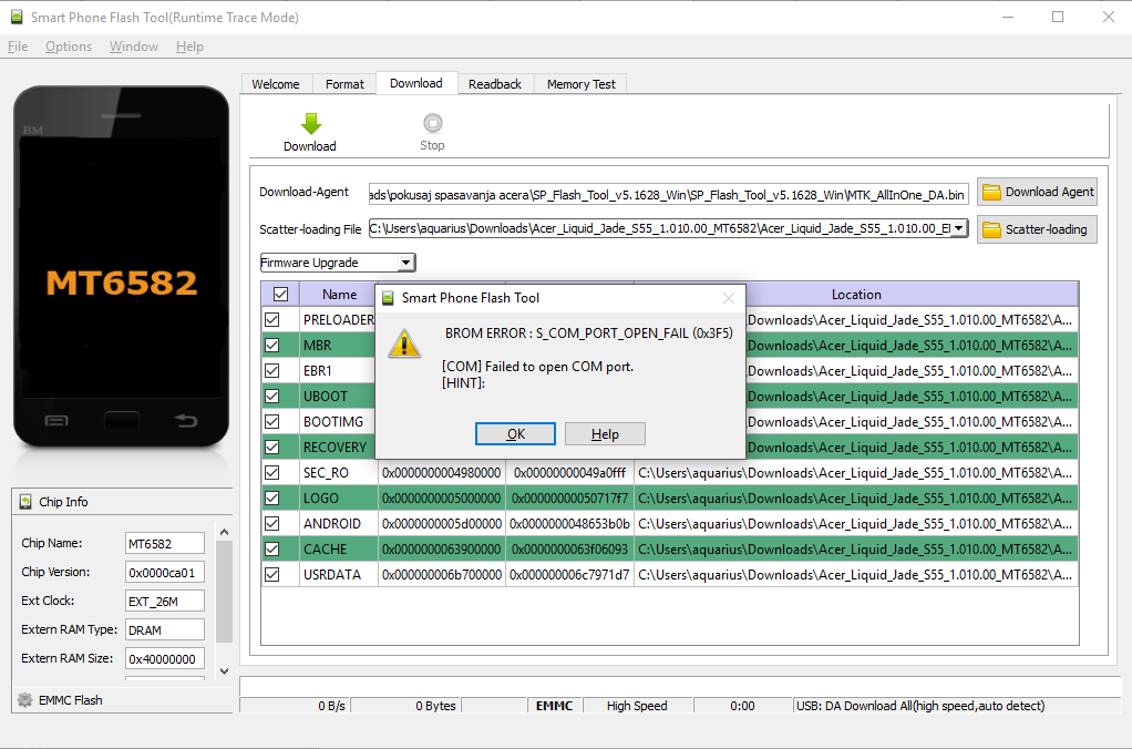

Sometimes I get "Failed to open COM port.":

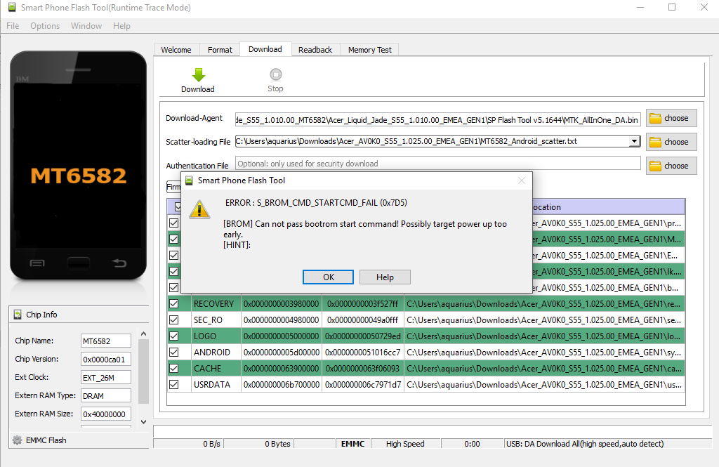

I even got this error couple of times:

(10-07-2017, 03:45 PM)МиливојКовачевић Tried firmware upgrade with different versions of the tool and of the firmware. Most of the times I get "Failed to get PMT info." error:

All these are problems connecting to the device.
