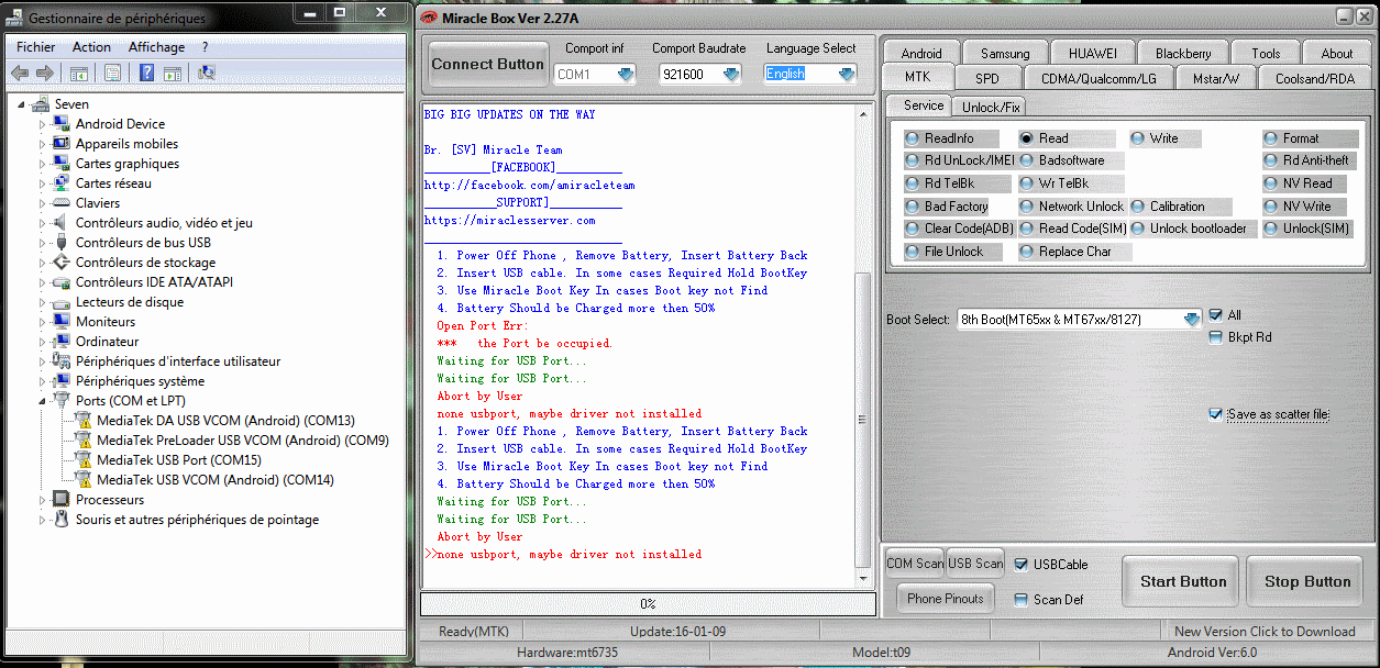

21-03-2017, 10:52 AM
Before seeing if I'm lucky ... I found more recent drivers (v: 3.0.1504.0) than those proposed here, after installation, one by one, with test between two. Same result.
And as far as your proposal is concerned-
1. the phone is in charging mode and is detected as a mass drive. No change of state of the miracle box.
2. the phone boot on the recovery menu, no change to the miracle box.
I want to try SP flash tool, but also, I have no way to extract the scatter file
edit : There is a way with ADB or other, to access the phone system folder and delete the file "recovery-from-boot.p" which I think hangs when I try to root my phone ???

49,570
21-03-2017, 12:02 PM
(21-03-2017, 10:52 AM)Ji_D Before seeing if I'm lucky ... I found more recent drivers (v: 3.0.1504.0) than those proposed here, after installation, one by one, with test between two. Same result.
I guess it'll have to be an SP Flash tool readback
Follow the guide @ https://www.hovatek.com/forum/thread-526.html and dump ONLY recovery & boot (one after the other)
No Need for MTK Droid tools since you already have scatter (MT6737M) @ https://www.hovatek.com/forum/thread-12724.html
You can obtain the values you need for the readback from the scatter file
physical_start_addr = start
partition_size = length
This post was last modified: 21-03-2017, 12:03 PM by hovatek.
